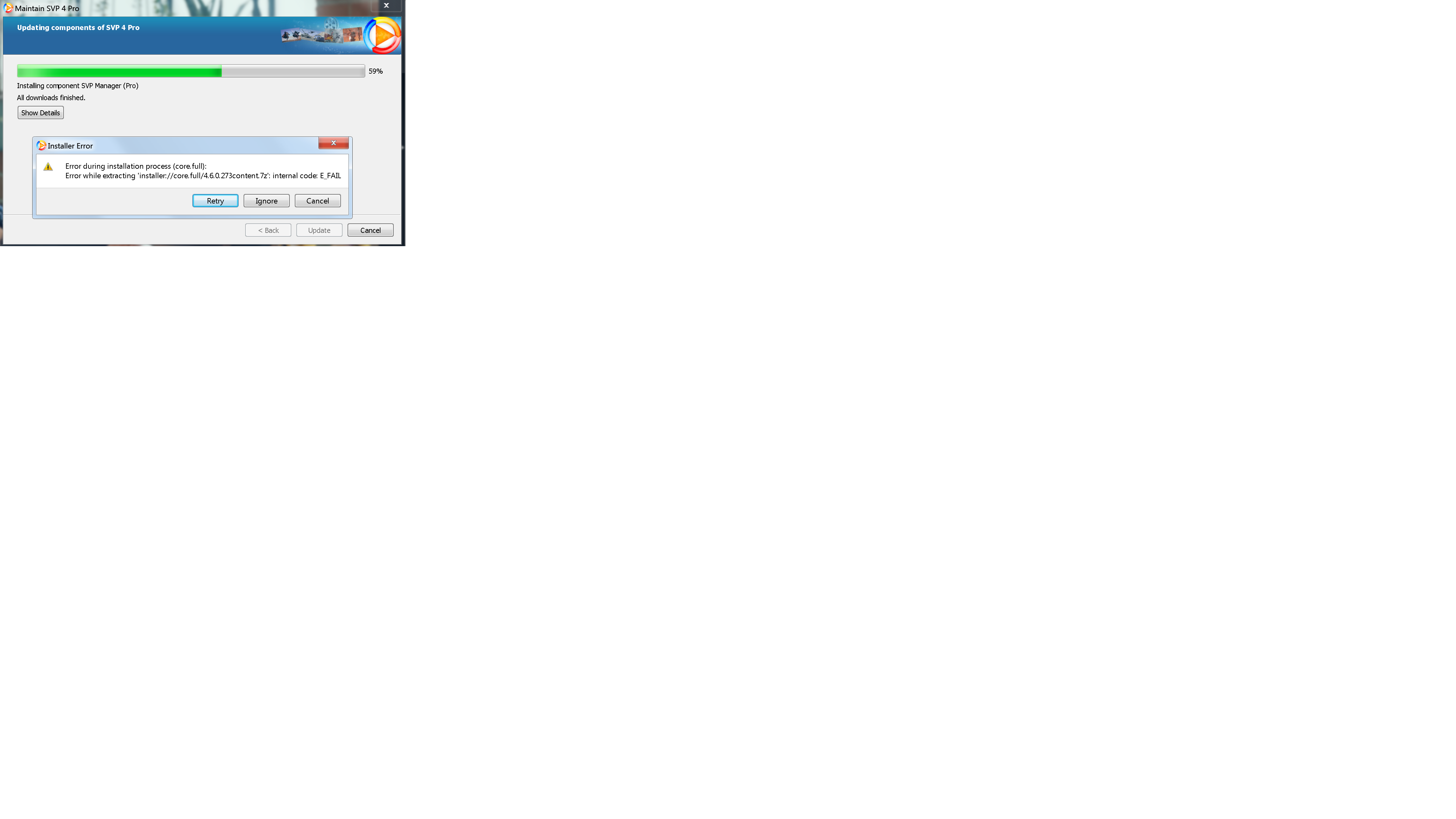

The latest update broke it.
In the middle of installing the updated files it showed an error message and a retry or ignore dialog, retry did not help so i pressed ignore. When the installation was done and restarted SVP it never started again, it seem the manager is gone somehow because trying to start it from the icon just give an missing object error now.
I am going to show the error in the update i got and i hope you can direct me how to fix my installation, please.
