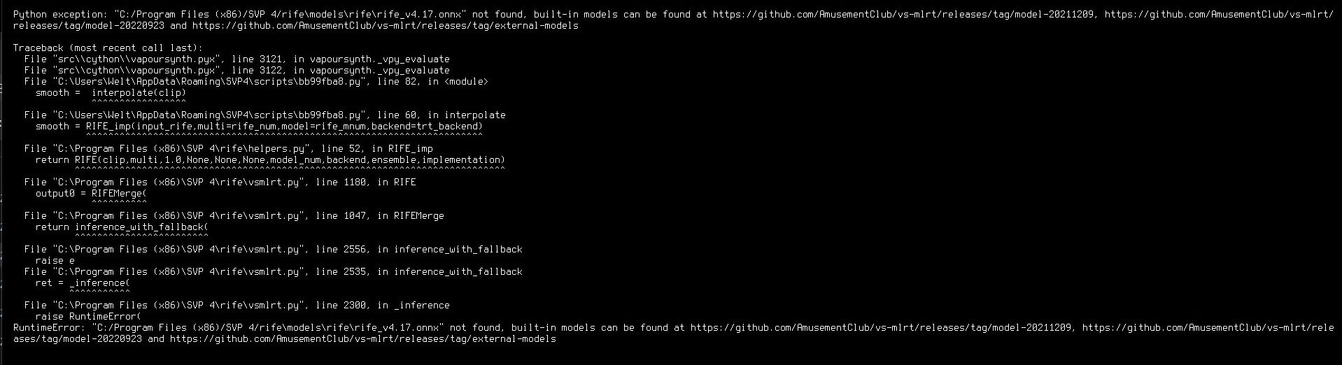

4) Switching to Tensor RT 15.x, it works swapping "vstrt.dll and the folder vsmlrt-cuda" only.
I noticed a bump of graphic card total power consumption (undervolted rtx 4090), about 5 - 10 % (differs in resolution, framerate, upscaling etc.)
5) If swapping the newer "vsmlrt.py" also from the TensorRT 15 file also, nothing works anymore; that means any machine learning based RIFE model and SVP's own interpolation. See image attached "error swapping vsmlrt_py".
Any way to fix from my side, you SVP developers side, or simply not swap the file?
6)
@flowreen91
Made the line change ("True"), nothing works.
See image attached.
Thanks in advance!
error changing line 52.jpg, 69.47 kb, 902 x 309
jdg4dfv7 wrote:
@flowreen91
Try with these:
https://drive.google.com/drive/folders/ … SzUp1SAzbx
