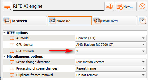

Hello,
My problem is this:
I get an error if i raise the GPU thread more than 1 (only 1 GPU thread speed is useless).
I have ATI 7900XT and didn't change the video card driver for a while because it was perfectly working with the 2 threads by this driver version: whql-amd-software-adrenalin-edition-23.11.1-win10-win11-nov3-rdna
I always have to go back to this version, because newer than this couldn't handle more than 1 GPU thread. But i can't stuck this driver version forever, so i have to go on an update and deal with the error.
Could you please update / make compatible the script for newer ATI video card driver version?
I am available for testing if necessary.
2024-06-25_073017.jpg, 32.89 kb, 588 x 71
2024-06-25_073043.jpg, 52.27 kb, 500 x 269
Re: RIFE: gpu_thread must be between 1 and 1 (inclusive)
This is what a Vulkan driver reporting about the hardware caps, we can do nothing about it.
Is there anything i can do about it? Any setting, another "unlocked" driver or tool?
It was worked before, so maybe have a chance to get back this somewhow.

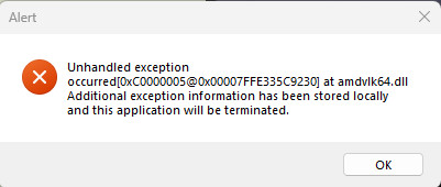

EDIT:  with MPC-HC i got this dump when i try to seek forward in the video:
rife_vs!VapourSynthPluginInit2+0x1baa7
rife_vs!VapourSynthPluginInit2+0x34f1d
rife_vs!VapourSynthPluginInit2+0x34903
rife_vs!VapourSynthPluginInit2+0x2cccf
rife_vs!VapourSynthPluginInit2+0x2c6f8
rife_vs+0x2235
rife_vs+0x505b
vapoursynth!getVapourSynthAPI+0xcadf
vapoursynth+0xfe1c0
vapoursynth_cp38_win_amd64+0x83eac
python38!Py_CheckFunctionResult+0x516
python38!Py_BuildValue_SizeT+0x884
python38!PyObject_GenericSetAttrWithDict+0xcf7
python38!PyDict_SetDefault+0x3be
vapoursynth_cp38_win_amd64!PyInit_vapoursynth+0x1732e
vapoursynth_cp38_win_amd64+0x4c31c
vapoursynth_cp38_win_amd64+0x4b906
python38!Py_gitversion+0x9af4
python38!PyEval_EvalFrameDefault+0x195a
python38!PyEval_EvalCodeWithName+0x228
python38!PyEval_EvalCodeEx+0x9b
python38!PyEval_EvalCode+0x2d
vapoursynth_cp38_win_amd64!PyInit_vapoursynth+0x1be5f
vapoursynth_cp38_win_amd64+0x709f8
vapoursynth_cp38_win_amd64+0x742dc
vapoursynth_cp38_win_amd64+0x74f19
vsscript!vsscript_evaluateFile+0x17b
vapoursynth_filter_64!DllMain+0x10e6a
vapoursynth_filter_64!DllMain+0xdf18
vapoursynth_filter_64+0x1938a
vapoursynth_filter_64!DllMain+0x16d3c
lavvideo!CLAVVideo::DeliverToRenderer+0x12b0
lavvideo!CLAVVideo::Deliver+0x273
lavvideo!CDecD3D11::DeliverD3D11Frame+0x1f9
lavvideo!CDecD3D11::HandleDXVA2Frame+0x107
lavvideo!CDecAvcodec::DecodePacket+0xcbe
lavvideo!CDecAvcodec::Decode+0x1a5
lavvideo!CDecBase::Decode+0x13a
lavvideo!CLAVVideo::Receive+0x219
lavvideo!CDeCSSTransformInputPin::Receive+0x5e
lavsplitter!CLAVOutputPin::DeliverPacket+0x4ae
lavsplitter!CLAVOutputPin::ThreadProc+0x272
lavsplitter!CAMThread::InitialThreadProc+0x4c
lavsplitter!thread_start<unsigned int (__cdecl*)(void *),1>+0x50
kernel32!BaseThreadInitThunk+0x1d
ntdll!RtlUserThreadStart+0x28
2024-06-27_141635.jpg, 22.61 kb, 401 x 170
gerappa wrote:
It would be good to know, how to solve this in other players...
Yep. Unfortunately, only those players' developers can solve this issue, since it's tied to the player's renderer. I don't know about PotPlayer's devs but MPC-BE devs have never been receptive to fixing issues they don't encounter themselves, so we're most likely out of luck with them.
Once i wrote to the Potplayer dev's for bugreport and gave some ideas... how to say....they were not nice.  So, i don't think they will fix anything.
There is no workaround sad
