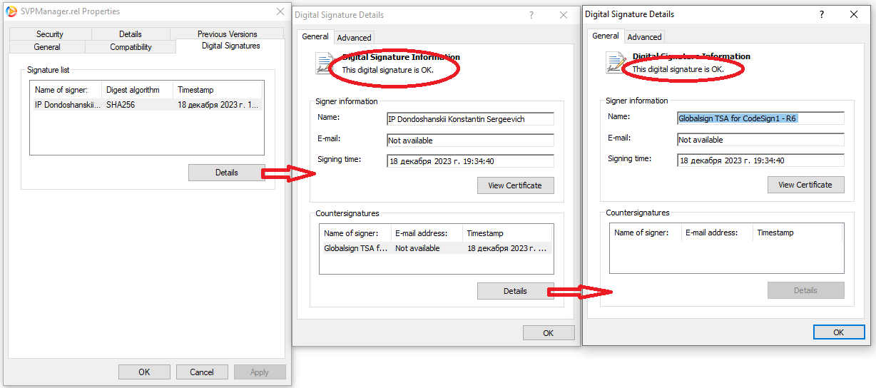

check SVPManager.exe properties, Digital signatures section - is everything OK there?

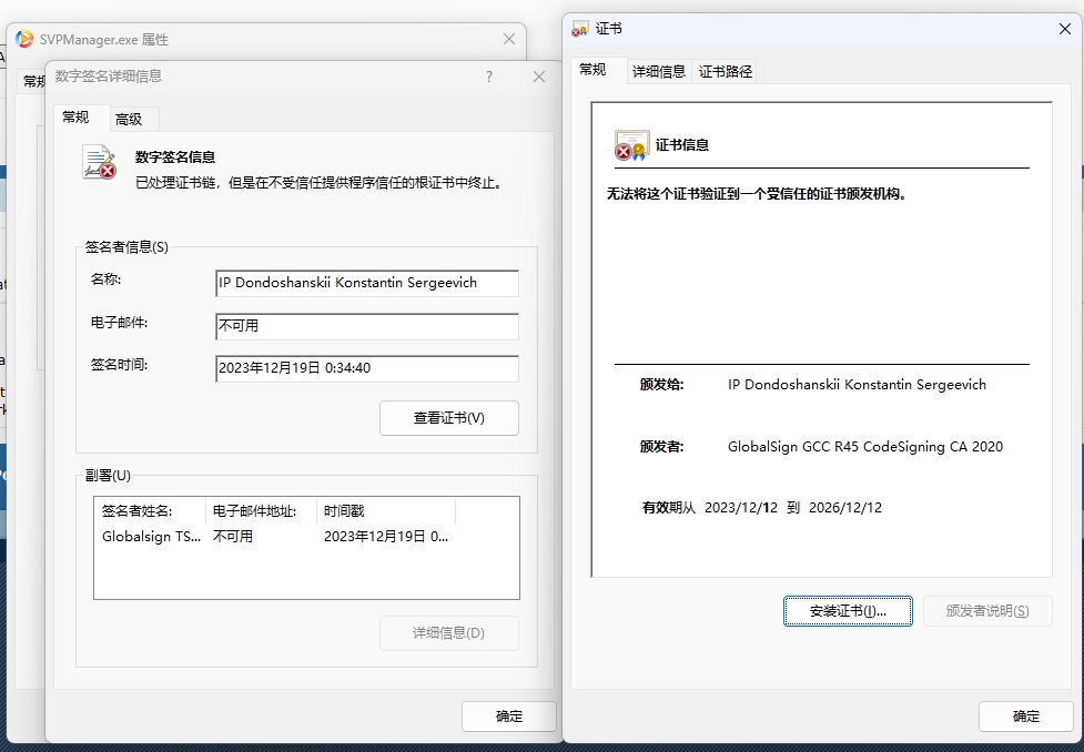

NO, how do i fix this?
1.png, 165.76 kb, 977 x 678

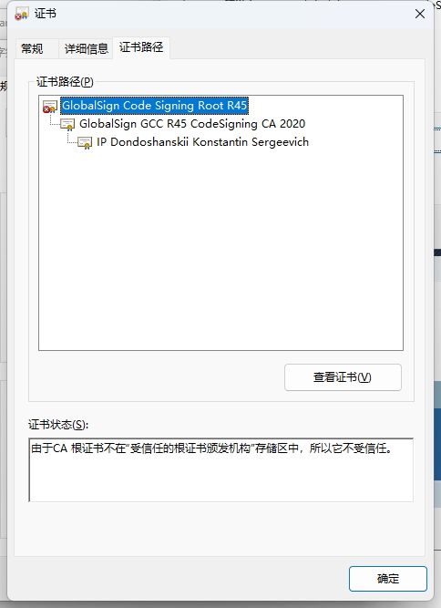

check "certification path" page, which one is not ok
you did something with system's root certificates?
"GlobalSign Code Signing Root R45" must be installed

I don't think i did something with it, it just happened.
How do i fix it? Where to download it?
1.png, 72.09 kb, 484 x 667

https://support.globalsign.com/ca-certi … rtificates
Re: Two weird issue need help...
All good now!! Thx!
