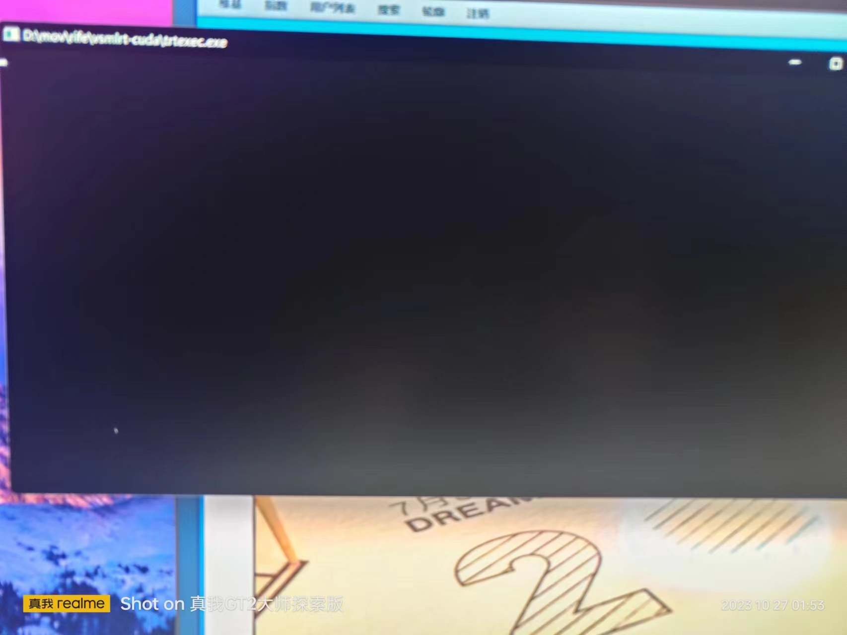

hello     Unable to use rife        Every time I play a video with rife tensorRt this popup appears
Re: reinstalled SVP, cannot make RIFE AI engine work anymore
1. Run
2. Wait for 6+ minutes
3. Watch
10 (edited by KK78S 27-10-2023 04:37:59)
I wait a while and then it stops working It doesn't work, it keeps popping up this blank popup ......
Before it worked without popups, now I reinstalled it
