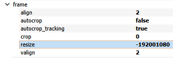

Unfortunately it doesn't work either. I would be satisfied if I could lower the 4K (3080x2160p) resolution a bit. but how do I do that? I set SVP resize to 19201080, but it doesn't do that?
Frame resize -192001080
изображение_2024-03-31_004145189.png, 3.42 kb, 344 x 116
