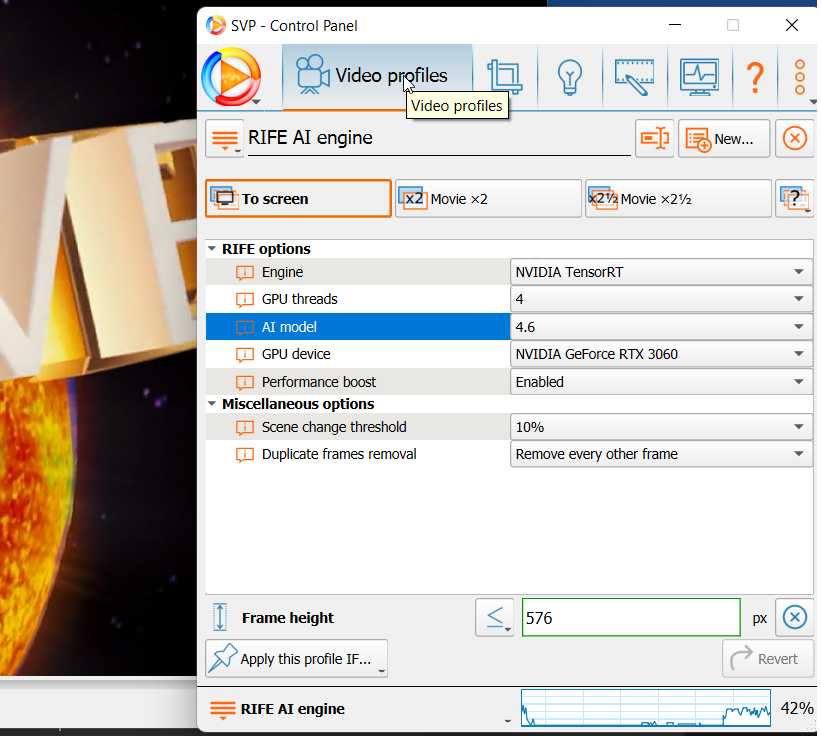

Hello everyone,
I'm using SVP with a license, and it works great for the most part, however I am having issues when choosing the RIFE AI profile. I have a NVIDIA GeForce RTX 3060 8GB. However I can't get this to work. Whenever I choose this profile, a command windows pops, and starts logging data, the video immediately freezes, after 5 minutes or so, it starts playing in 2-second chunks, then it freezes 1 second, and then plays another 2-second chuck. I don't know what to do here. This is a 1.3 GB MP4 file, it should be such a burden to reproduce.  I appreciate your advice.

meaning 3060 is too slow for what you want from it

Fabian try to play around with the resize setting until it works for your system:

Change the last setting, "Duplicate frames removal" to "Do not remove" and try playing it.
I had a similar experience.
You're right! It significantly impacts the performance. I wonder why this option is even available, as it could easily confuse newcomers who might accidentally activate it.
Re: Video freezes when choosing RIFE AI Engine profile
Thank you, issusi. Of course it is BIG mistake to use Remove every other frames value with common videos. It is very special setting for special cases.
