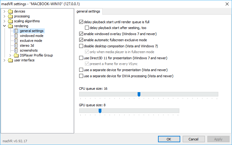

Re: Can't right click when fullscreen? Change default
Check madVR settings and version.

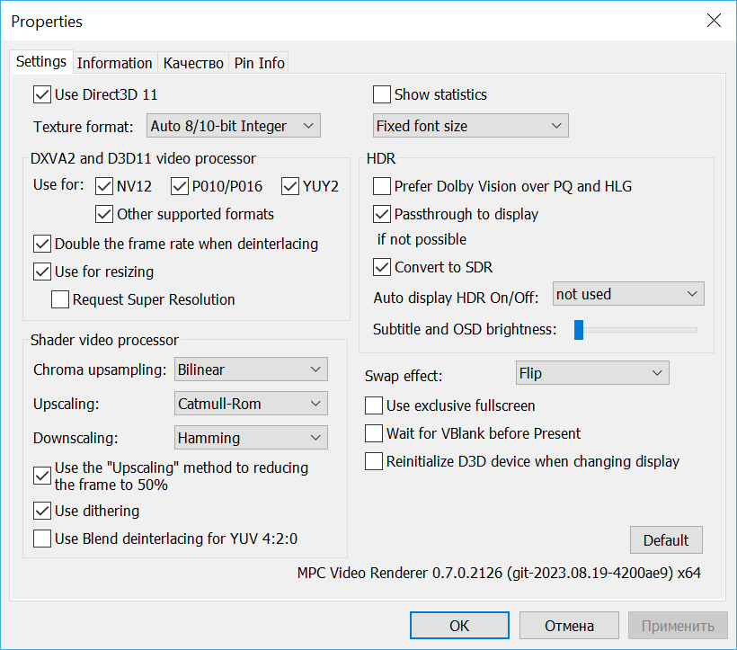

MPC Video Renderer -> Use exclusive fullscreen = off
Oh yeah that works. why is it not available in exclusive fullscreen thats strange...?
Oh! Yes. Sorry I missed it.
I thought you are using madVR. Now I see You are using MPC Video Renderer.
Then check MPC Video Renderer settings: Start playback video in MPC-HC menu Play > Filters > MPC Video Renderer
I think you need to turn off option 'Use exclusive fullscreen'
P.S. You have done it already. OK
Exclusive mode can draw only one window. It gives more stable playback and can help if you have micro jumps when playback.
Any context menu or sliderbar - is one more window for MS Windows.
