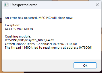

Hi, after installing last update I have an error when I launch a video with MPC.
Capture d'écran 2023-10-02 202609.png, 15.83 kb, 355 x 255

you'd better send a report from the app right after the next crash
does it crashes for a specific video, or any video you have?
Re: Error with MPC
RIFE/TensorRT doesn't work via Avisynth.
Avisynth Filter must not crash, but still it won't work this way even if we fix this crash.
Re: Error with MPC
Yes, any videos, only if I activate Rife AI or duplicate frames removal mode.
I send the message with app like you say, thank you.
It's strange because Rife are always work even if vapoursynth is not selected, I have a message who say I have not activate, but run with no problem, but not with last update.
Re: Error with MPC
ok, crash fixed (update AVSF)
however, one more time, RIFE/TensorRT works via Vapoursynth only
when you run it via Avisynth it shows a warning message and falls back to Vulkan version
Re: Error with MPC
Hey, I download the last update and yes I confirm all problems are disappeared. Very thank's to the Team. Ok for the Vulkan version, I didn't know that, but load in 5 seconds, it's very effective.
