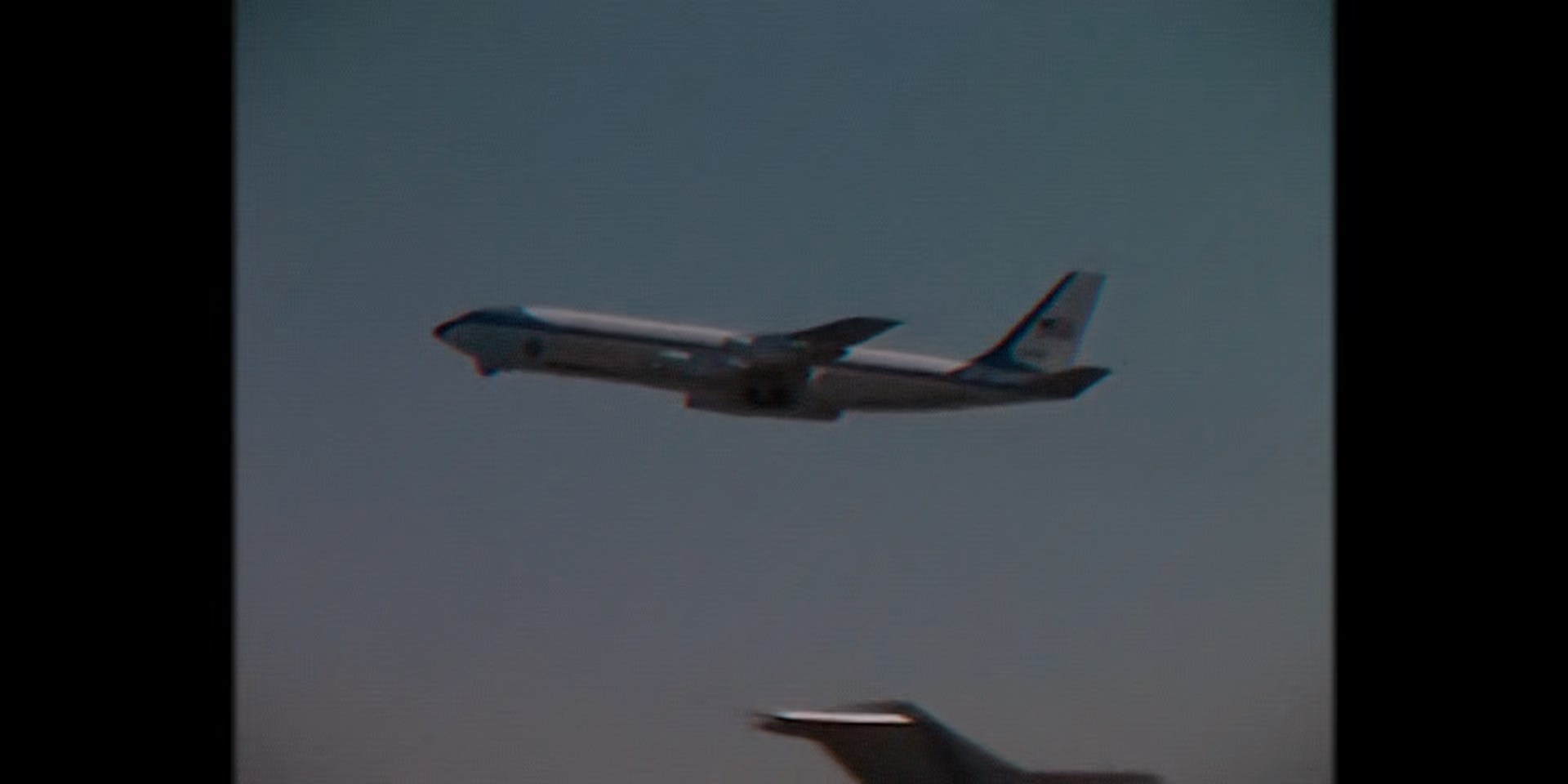

I'm watching "For All Mankind" which is set in the '70s and '80s. The episodes sometimes include 4:3 aspect ratio sequences. SVP4 seems to have issues with that, it has trouble switching between 16:9 (well, 2:1 in this case, since the video is 1920x960) and 4:3 when they're in the same file.
I don't even know how it's possible to set this inside a file - but apparently it is (segments? I'm looking at an MKV).
Attaching several images. "AR 4x3 incorrect" shows a scene that got "stuck" in the wrong AR; "AR proper for segment" shows the same scene with SVP disabled. "AR 4x3 previous segment" shows the scene immediately prior to this.
Also, whenever this change happens - SVP just goes bonkers for a good moment (it's probably throwing its buffers away and re-doing the look-ahead). Still, those moments only last a few seconds, so it's annoying that this can't happen faster.
What further info can I provide? I can't give you a sample of the file (several hundred MB), but I can point you to a torrent of it ("For All Mankind", S02E10 at around 43:10).
SVP v4.6.0.246 / Windows 10

I've downloaded and looked your video.
It is usual video with constant frame resolution 1920x960.
Base video source have this resoution and only small part of scenes has 4:3 screen aspect ratio and black borders from left and right sides.
To avoide resolution changes best solution is to disable SVP option: Video frame > Detect and cut off black bars
Or you can open Advanced controls option of Video frame menu, press and hold button Black bars detection and select option: One time only
Re: Mixed aspect ratio video sometimes gets stuck on wrong AR
Ah, so I can disable this entirely.
That's fine, because I prefer to see the original video without alterations anyway (if it bothers me, I can always zoom in with the video player).
