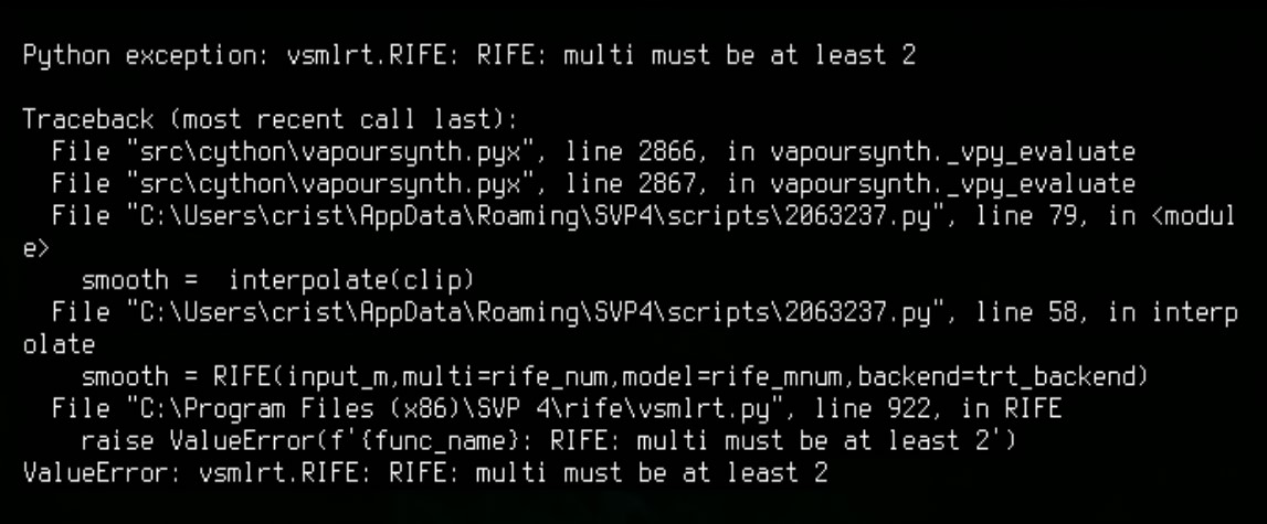

Hi, Im getting this error with SVP4 and RIFE ''Python exception: vsmlrt.RIFE: RIFE: multi must be at least 2" What does it mean? How do I fix it? Thanks in advance

Sorry, when I created the post I attached an image but apparently it didn't work. The error happened when trying to watch a movie with MPC. Now I attach an image

Re: Python Exception with vsmlrt.RIFE
the video is already at 60 fps, there's nothing to do for SVP
Python error in this case is an _error_ that will be fixed
