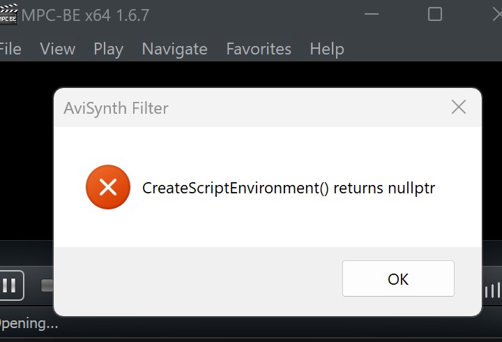

So I just installed SVP and added avisynth in mpc-be external filters. The problem is, whenever I try to play a file or open the avisynth filter via the external filters menu I am getting an error. Attached is the error.
I tried installing avisynth2, avisynthplus but nothing works.... Please help...

You only need to install Avisynth+: https://github.com/AviSynth/AviSynthPlu … redist.exe
SVP installation does this automatically.
If you have avisynth.dll in MPC-BE's folder - remove it.
If you have avisynth.dll somewhere in PATH other than in C:\Windows - remove them.

Yes I have also installed that one. Should I just run a search for a matching avisynth.dll in my local drive then delete everything aside from the one in C:\Windows folder?
4 (edited by khestoi 01-06-2023 11:05:22)
Re: avisynth issue
Okay I reinstalled avisynth+ and the error is no longer showing up but SVP still says no active playback... I followed the steps in the wiki already.

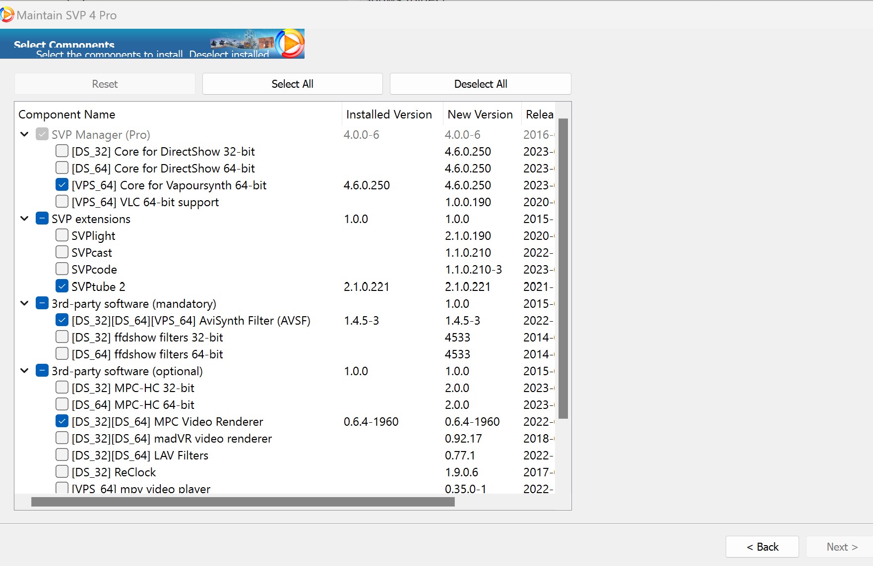

I am seeing this in the logs:
19:04:20.061 [W]: AVSF: 64-bit SVP engine is not installed.
Do I need to reinstall svp?
Re: avisynth issue
if you didn't checked 64-bit components at the installation time you can install them from menu - Utilities - Add. programs and features
Re: avisynth issue
I have installed the 64bit version during installation and this is what the add components look like:
Do I need to reinstall?
7 (edited by khestoi 01-06-2023 12:15:24)
Re: avisynth issue
okay looks like I need to manually restart SVP.... it works now but seeing these in the logs if I use the RIFE engine

Re: avisynth issue
if you want _Vapoursynth_ Filter in video players other than mpv you have to set up env. variables
and use SVP's provided Vapoursynth installation, not your own
if you want your own installation then there must be a MiscFilters plugin installed
