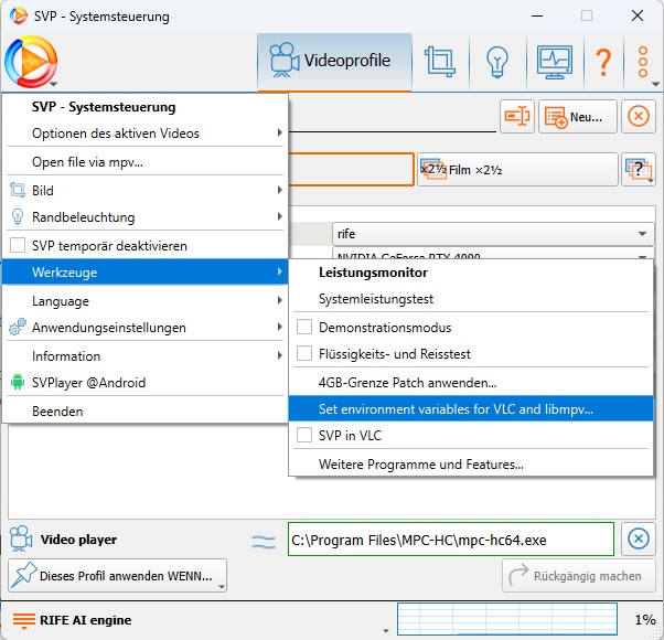

I tried today ..
MPC-HC shows:
23:23:24.207 [E]: Playback [c85b13c2]: AVS - RIFE: failed to load model\n(C:\Users\patri\AppData\Roaming\SVP4\scripts\c85b13c2.avs, line 62)\n(C:\Users\patri\AppData\Roaming\SVP4\scripts\c85b13c2.avs, line 77)
I thought i could do this:
SVP menu -> Utilities -> Set environment variables for Vapoursynth
but this is not selectable, my SVP looks like this:
vapoursynth.jpg, 107.51 kb, 602 x 580
No change , same error , any ideas
thanks in advance
must be on your side, My MPC-MC+MPC Video Render + Vapoursynth Filter works perfectly fine with RIFE. Better results than MPV.
make sure there is no other vapoursynth path in your system PATH.
here is mine
https://media.discordapp.net/attachments/290709370600423424/1062486253313990697/image.png
Thanks for your  advice, delete other path in the variables
Now no error pop , but the player closed when open any movie.
