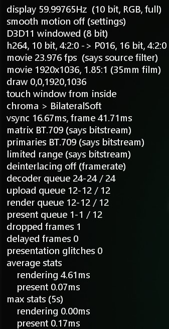

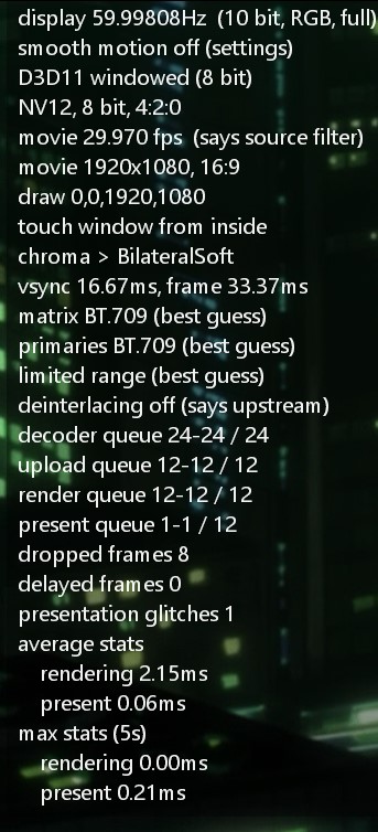

I just purchased SVP not long ago, using the latest version (4.5.0.213)
Videos other than h264 can be displayed normally at 60fps
But only when I play h264 video, 60FPS Ignore HFR sources will be displayed in the lower left corner, but 60fps cannot be displayed
When I changed the FPS value in the Ignore HFR sources profile to 61FPS , Ignore HFR sources are no longer displayed in the bottom left corner
Is this a bug? Or is there something wrong with my settings?
My player is MPC HC, I use madvr LAV, etc.
The above situation does not improve whether I use AyiSynth or ffdshow
This is the information when I play H265, SVP works and shows 60FPS
https://imgur.com/qKo7QDl
1.jpg, 87.54 kb, 343 x 754
2.jpg, 90.99 kb, 337 x 654

Re: SVP does not work properly when playing h264 formatted videos
Source filter says 23.97 - it is normal to madVR statistics. This info can either 23.97 or 59.94. Depends on Source and Decoder Filters.
I think you understand diference of source frame rate and  output frame rate. You can see details about filters in potpayer context menu Filters or Playback/System Info...
I see SVP firstly does interpolation to 59.94 fps (Green OSD in left bottom corner). What is happen next you can see in Events log:
