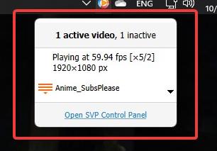

So I've been working on this and now I still see in the logs:
18:23:16.305 [i]: AVSF: found new player instance
18:23:16.338 [i]: AVSF: filters in use: LAV Splitter Source -> LAV Video Decoder -> AviSynth Filter -> * -> Madshi Video Renderer
18:23:16.341 [i]: AVSF: new video in PotPlayerMini64.exe (64-bit) [PotPlayer 0.0.0.0] on screen 1
18:23:16.391 [i]: Media: video 1920x1080 [PAR 1.000] at 23.976 fps
18:23:16.391 [i]: Media: codec type is AVC, YUV/4:2:0/8 bits
18:23:16.393 [i]: Playback: starting up...
18:23:16.399 [i]: Playback [9ba355f2]: Frame server (64-bit) C:\Program Files (x86)\SVP 4\mpv64\vapoursynth.dll
18:23:16.400 [i]: Playback [9ba355f2]: resulting video frame 1920x1080
18:23:16.401 [i]: Playback [9ba355f2]: 2 acceptible profiles, best is 'Anime_SubsPlease' [100]
18:23:16.402 [i]: Playback [9ba055de]: disabled while video is paused
18:23:16.404 [i]: Playback [9ba355f2]: enabled while video is playing
18:23:16.405 [i]: Profile: using automatic profile #1 /animation
18:23:16.407 [i]: Playback [9ba355f2]: playing at 59.94 [23.976 *5/2]
18:23:16.412 [E]: Playback [9ba055de]: VS - Script error: expected `('\n(C:\Users\htpc user\AppData\Roaming\SVP4\scripts\9ba055de.py, line 7, column 6)
SVP4 shows, see attached, 2 videos same name one active and one inactive, any idea what is happening?  and why?
ERIC

Re: SVP and Vapoursynth receiving an error in script on execution
"AVSF: filters in use: LAV Splitter Source -> LAV Video Decoder -> AviSynth Filter -> * ->"
why the hell you're putting both Avisynth and Vapoursynth filters simultaneously? hmm

Notice I'm still getting:
which is the line: "if not hasattr(core,'svp1'):"
However I've ensured that the I have only 1 copy of python and it works on the command line on through SVP am I seeing it (see above).  I was also having an issue with Windows 11 and AviSynth so I had removed that, now it is back again, so yeah not sure why I had both enabled, but the python error is still a problem even then.
