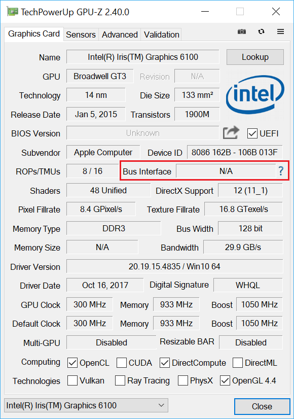

How to check PCIe speed. Download GPU-Z
https://www.techpowerup.com/download/techpowerup-gpu-z/
Click at "?" button and press: Start Render Test. After few seconds you will get measured speed.
GPU-Z_PCIe_bus_speed.png, 56.31 kb, 580 x 826

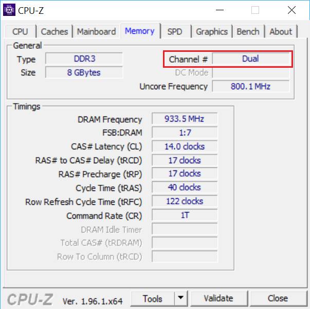

Also you can check memory bandwidth. Open CPU-Z and look at Memory tab. You need to see Dual channel mode instead of Single.
https://www.cpuid.com/softwares/cpu-z.html
CPU-Z_dual_channel.png, 97.53 kb, 603 x 602
