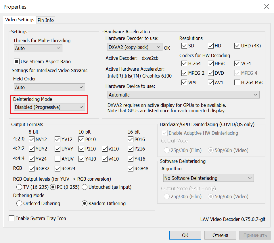

Re: A lot of BBC programs choppy
I've download this episode: dragons.den.s18e14.1080p.hdtv.h264-m0retv[eztv.re] (1.57 GiB, 58 min 50 s)
And I see what the video is decoded by LAV decoder as Interlaced instead of progressive flag:
Scan type                      : Progressive
So, I had to force enable progressive scan in decoder to get smooth picture and to remove lags.
To repeat this you need to set Deinterlacing Mode = Disabled (Progressive) in LAV decoder.
While playback or pause in MPC-HC menu Play > Filters > LAV Video Decoder.
LAV_force_progressive.png, 52.02 kb, 953 x 846

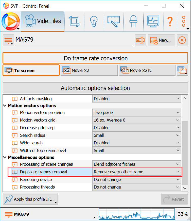

Solution for mpv player (and any other players besides the players, using LAV decoder).
1. Change setting of SVP profile "Ignore HFR sources": Video frame rate from value 47 to value 55 (for example).
2. Open this video and change setting in active SVP profile: Duplicate frames removal set to value Remove every other frame
It is fast solution for this video file. One can find another way. smile
SVP_remove_duplicate_frames.png, 72.25 kb, 765 x 871
