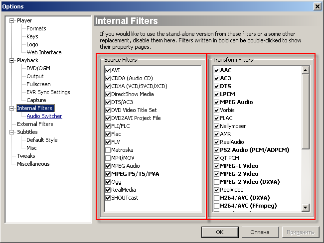

With DS-Filters you mean, the output in mpc when pressing O and change it there? i use media splitter. It wont work when i use evr custome pres so i was wondering reinstall and try it with set setting?

No. DS-filters are:
1) splitter
2) decoder
3) renderer
You can check it from MPC context menu: Filters.

Re: 24p vs 48p(FFdshow framerate double) vs 60p(SVP)
1) splitter. You can switch on/off using of internal splitters in MPC: View - Options - Internal Filters - Source Filters (see pic);
2) decoder. You can switch on/off using of internal decoders in MPC: View - Options - Internal Filters - Transform Filters (see pic); When internal decoder is off you can choose which decoder to use: View - Options - External Filters.
3) renderer. You can choose it from View - Options - Playback - Ouput.
I usually use: 1) Matroska Haali + 2) CoreAVC + 3) EVR Sync
