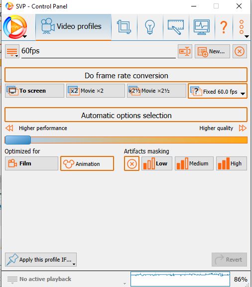

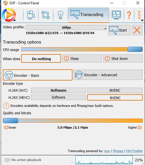

I have problem that when i transcode 1080p anime video (24min) 24fps 300mb to 60fps i got files like 3GB when using minimal bitrate. How to make files under 1GB? My settings are in attachments.
What should i change?

Re: Files too big after transcoding in SVP
yep, it's a "quality/bitrate" slider actually was broken after update to Qt 5.15
please update now
3 (edited by lowzyyy 10-10-2020 11:56:02)
Thanks. Now file size is lower (~780mb) but still i think slider should go lower than 5mbps. Anyway i found in advanced encoder for NVENC that i can put my own bitrate so i put 2mbps which is a little hiher than my source bitrate (~1700kbs). Files are now almost the same (~380mb)!
the same size doesn't mean the same visual quality
Yes of course, but i dont know how beneficial is to transcode in 5mbps when source is in 1.7mbps, or its not? I tried with 19mbps and 2mbps. Cant see the difference
