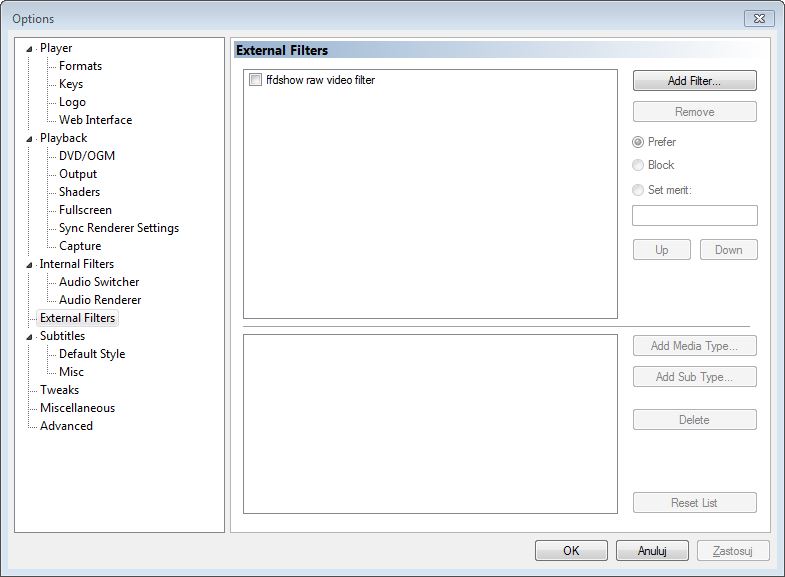

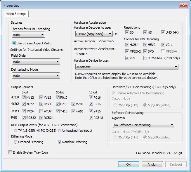

Ffdshow filter is deactivated [att. 1] and at [att. 2] is my video decoder settings (but I think try to change everything and it doesn't do any good).

Re: Problem with vidoe after install SVP
hmmm..... video driver may also have some image/video enchantments / color correction enabled
@Chainik: Do you know where can I find this?
NVIDIA -> Nvidia control panel
Intel -> Intel graphics settings
AMD -> AND radeon settings
Thank you. It was good leed.
Somehow settings of video driver in integrated card was changed! Saturation was 1.5 (default is 1.0)… and some other option were not default.
