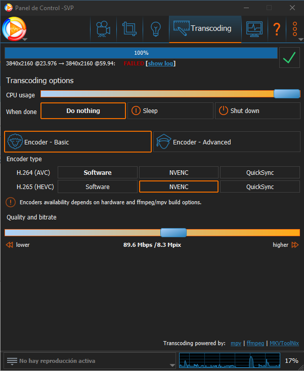

Hi, I'm having some problems using SVPcode to transcode a 4k 24fps video to 4k 60 fps. I'm getting an error [vapoursynth] No PTS after filter at frame 244!
Attached are the settings I'm using, the coder.log file with the error and the opencl.log.
I've also tried Software and QuickSync encoders for both H.264 and H.265 (all combinations basically), and got the same message for all of them.

Yeah, I can see this error too, which means there's something broken in the video itself.
I'll check if we could implement some workaround...

please update SVP now
the video was encoded with a strange timecodes at frames ~90-95 and svpflow plugin didn't handle those negative and zero values correctly
