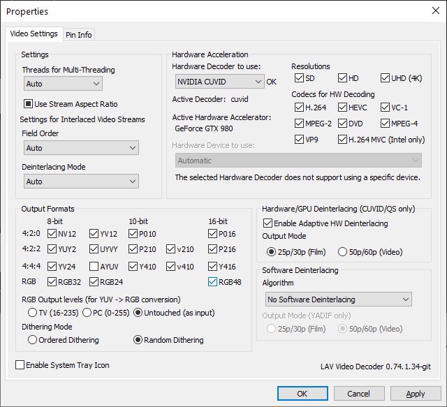

SVP is running at 50fps. So I would say that frames are interpolated to make 50fps out of 25fps, but SVP shows no activity at all. I've been altering many settings, to no avail. See attached file for my LAV video decoder settings. Should be good, but I've experimented with several settings for hardware decoder but nothing changes.
For the record, with normal 24fps files SVP works great. Just for these files SVP doesn't seem to kick in no matter what settings I change. So clearly I'm missing something. What I can make of it is that the video is seen as interlaced and somewhere in the chain it's deinterlaced to 50fps (despite my LAV setting for film mode) so SVP can't interpolate any frames. But I have no clue where I can change settings for this. I'm using MPC-HC 64-bit, Madvr and LAV filters.

uncheck App. settings -> Add. options -> "assume double frame rate for interlaced videos"
Re: No frame interpolation with 25fps video
Ahhhh, never would have thought of that. I'm gonna check it out this evening. Thanks for the reply, been looking everywhere to solve this.
Works like a charm. Thanks.
