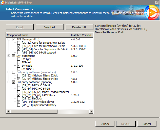

I downloaded the full package from here https://www.svp-team.com/get/, and installed the following:
Capture.PNG, 60.42 kb, 632 x 515

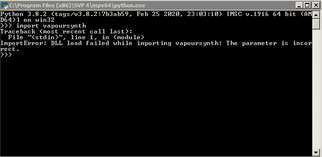

Re: SVP 4 Transcoding Issue
run SVP 4\mpv64\python.exe
type
>>> import vapoursynth
does it give any errors?
Yes it did give this error:
Capture.PNG, 9.96 kb, 661 x 324
try to update SVP - you'll see an updated Vapoursynth package, ver. 50
from the changelog:
> fixed regression in r49 where the python dll could only be located when in the PATH on windows
probably it's related hmm
