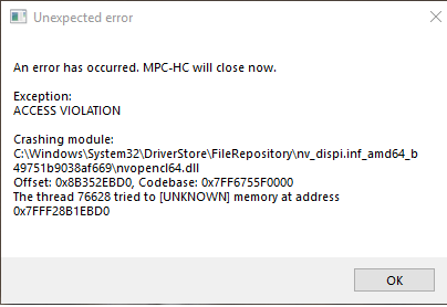

I can't run svp at this point. It crashes no matter what i do within a minute whether a movie is ru nning or not.

nvopencl64.dll is library of GPU drivers.
Looks like something corrupted in it. It can be in some cases after Windows 10 updates.
It can be fixed. Just reinstall NVIDIA GPU drivers with clean install option enabled.

Did yesterady and clean installed them after using DDU, still the same issue.

Maybe it is Intel?
I see in the log:
12:37:43.653 [i]: CPU: Intel Core i7-8700K [base frequency 3696 MHz, 12 threads]
You have Core i7-7800K. It has intergated graphics. But I see in the log:
12:37:43.913 [i]: Video: 1 GPU OpenCL device(s) on Intel(R) OpenCL [OpenCL 2.1] (Intel(R) Corporation)
12:37:43.913 [i]: Video 1: Intel(R) UHD Graphics 630 (Intel(R) Corporation, ver.25.20.100.6374) [gpuID=21]: OK
12:37:43.913 [i]: Video: 0 GPU OpenCL device(s) on Intel(R) OpenCL [OpenCL 2.1] (Intel(R) Corporation)
It is wrong because OpenCL on Intel detected twice. Second time with 0 GPU OpenCL devices.
Try to reinstall Intel GPU drivers. Use DDU again.

Oh, i think it crashes because even if i choose 2080 as the rendering device, it uses both the integrated and the 2080. Cause i use both intel hd graphics and 2080 these days. Could you see if you could debug it in a future update to use either of the 2?
