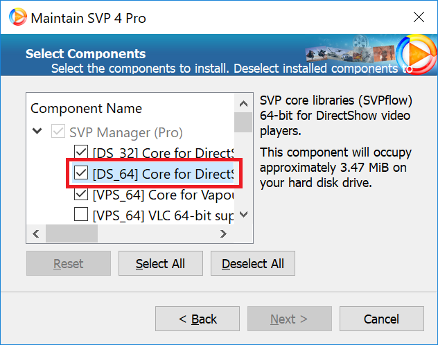

You need to install all [DS_64] components. Especially this one:
64-bit SVP engine.png, 54.59 kb, 632 x 498
