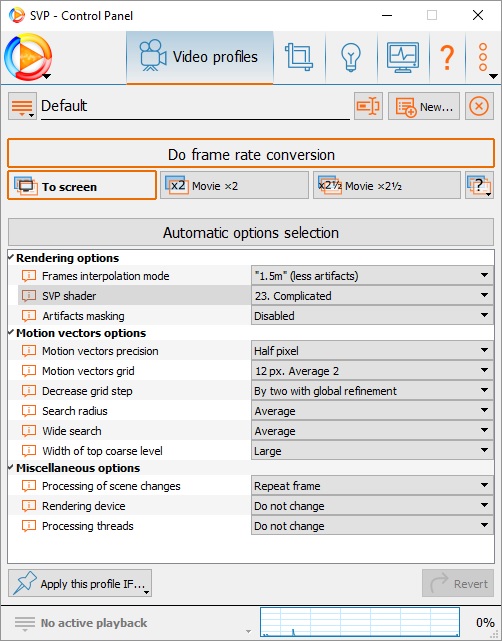

7 (edited by Moondust76 03-08-2018 09:23:51)
Re: Building new PC - Requirements for SVP @ 4k
@Nintendo Maniac 64
What do you think of these settings for 1080p @ 60fps? Running on an i7 2600K @ 4GHz with an GTX970. Seems to do well, almost no visible artifacting.
SVP4_settings.jpg, 109.11 kb, 502 x 641
8 (edited by Nintendo Maniac 64 03-08-2018 09:36:59)
"by two with global refinement" can be a killer of CPU.
With that set to disabled, even my Xeon 3470 @ 2.93GHz can run those exact settings but with "frames interpolation mode" set to 'Uniform' with even software-decoded 1080p 5mbps HEVC @ 25fps --to-> 62.5fps (2.5x) as long as I'm using a 64bit media player (because 32bit HEVC software decoders are quite unoptimized).
For reference, the that 1080p 5mbps HEVC 25fps video interpolated to 62.5fps was my go-to stress test when I was setting up this Xeon system with the logic that, if my hardware could do that just fine, then darned near any 24fps 1080p video should be able to work without issue (unless it was HEVC with a pretty crazy bitrate).  For actual real-world use I'd use 2x interpolation for 25fps videos as my display can run 50Hz without issue (but it can't handle anything above 60Hz without skipping frames).

Most of the time I'm running 25-30 mbps H264 24fps video @ 60 fps and that seems to go well with the above settings. But I have to admit that for quite some settings I don't know what's better. The user manual isn't really clear on some points as well. Like any SVP user I'm looking for the ideal settings that my cpu and gpu can handle. Is there a guide somewhere to do this step by step?
Unless it's in 10bit or you're using mpv, the bitrate doesn't matter for H264 video as that can be hardware decoded on any GPU made in the last 10 years without issue.
And with that hardware decoding I wouldn't be suprised if you could even disable your i7's overclock and you'd still be fine - heck my own Xeon locked at its turbo clock of 3.2GHz combined with H264 hardware decoding almost gets me there when using your exact settings - around 80% of the time it's running at 1.0x SVP index while it's only at 0.9x or so for the other 20% in certain scenes that are apparently more demanding (it's not clear why however as the entire test video is full of motion).
