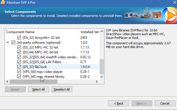

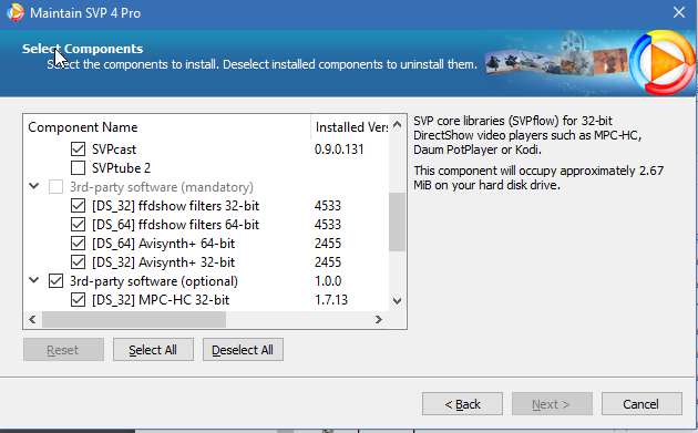

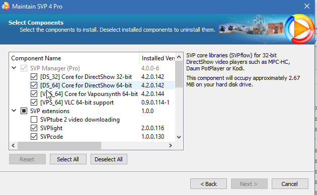

I just installed SVP 4 Pro for Windows on my Windows 10 Pro desktop computer. I had initially selected for SVP to install all components/extensions and right after I finished the installation and entered the license information, I found myself unable to open SVP 4 Pro Manager. I tried restarting, etc. but nothing seemed to work. I decided to start removing components/extensions via "Maintain SVP 4 Pro Installation." After removing them one by one, I was able to isolate the problem to SVPTube 2. After I removed SVPTube 2, I was able to successfully launch and run SVP 4 Pro with all of it's other components/extensions. Does anyone know how to get SVPTube 2 to install and run correctly? I have attached screenshots of the components/extensions I have installed currently.

Re: SVPTube 2 (Version 2.1.0.122) causes SVP on Windows 10 Pro to not open
SVP log? (see %APPDATA%\SVP4\logs\active.log)
Any crash message in the Windows Event Viewer? (Windows logs -> Application)
Do you have any Python version installed?
