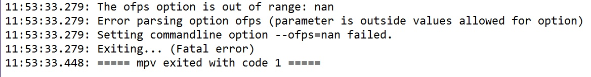

everytime I try to transcode a video with a VFR the transcoder displays IFR and OFR as 0 fps and the transcoding fails claiming that the OFR is out of range and not a number.
Is there a workaround for this without converting from VFR to CFR?

anyway, DO NOT process VFR videos with mpv+SVP, it will break things (because SVP have to force fixed output frame rate)
