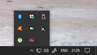

Hi, I spent over two hours trying get SVP to work after I reinstalled my system (win10). Before that it was working fine I just had to run the installation file and keep clicking "yes", did the same thing this time and it didn't work.Everything was installes successfully but for some reason, svp won't turn on, whenever play something using MPC-HC only ffdshow icon shows up (pic attached below). I will be really thankful for any help smile

It worked fine when the drivers were uninstalled, the moment I installed them back again and I came back to the starting point- svp doesn't launch, only ffdshow appears in the taskbar
