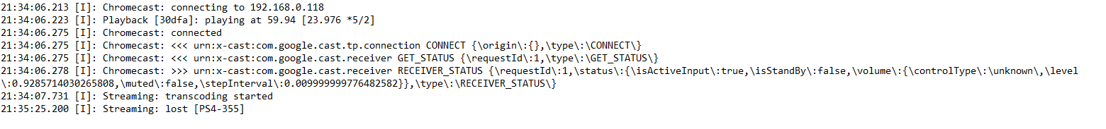

No image on the tv, cpu at 100% gpu at 11% barely reaching up to 25-26 fps. Encoder is nvenc x264, software was just at 2 fps lol
ACOTrFl.png, 25.83 kb, 855 x 271

> I found the setting for it on my own.
good for you! now look in SVP's Events log...
and play some "normal" video, not 4K
your hardware obviously is too slow for streaming 4K
