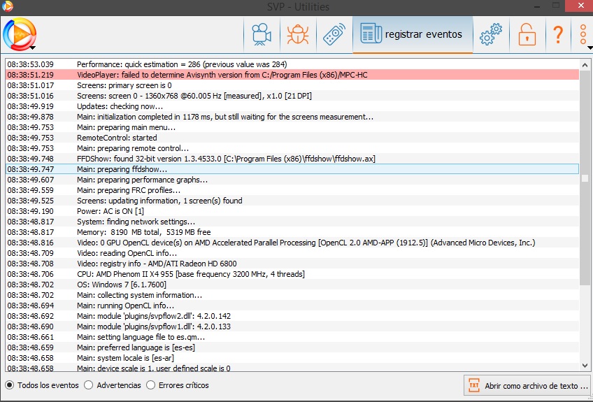

Hello, I am new to the forum. Sorry for my English... . The issue is as follows, I just installed the svp free, when I start it tells me this error (you can not locate avisynth).
Then I leave the log of the log so they can see what it says

Avisynth was not installed for some reason.
Do you see "Avisynth+" in the installed applications list?
Try to run the installer manually: https://www.svp-team.com/files/gpl/AviSynth_plus.exe
Re: help do not locate avisynth
hello, check the list of installed programs and the avisynth + was actually installed. Another thing to have to check?
- is c:\windows\syswow64\avisynth.dll in place?
- (re-)install VC++ 2015 32-bit runtime manually: https://www.microsoft.com/en-us/downloa … x?id=52685
Thanks, in the end it was c ++ 2015, uninstall and reinstalled it, and it worked
