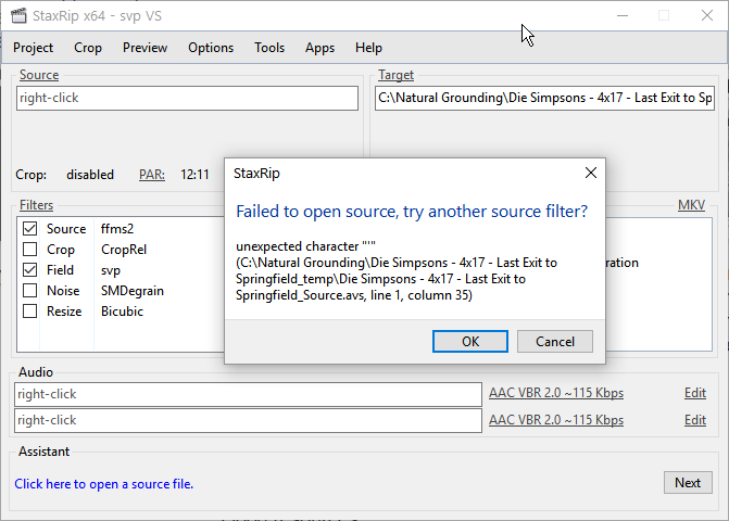

Here goes:
When I follow the instructions here, I always get the following error message (attachment #1)
The mentioned line in the script is seen in attachment #2, it is the space in front of the "r".
Deleting the space does not solve the error (as the file just gets overwritten again).
Any idea what is the problem here?
line 1, col 35.png, 2.26 kb, 525 x 21
I got the same problem and i've solved change ' to ".
but i have got another problem.
everytime when i try to open a new source, i got an error about 'Fail to open source, try another source filter'.
so i try to open with an option of 'vapoursynth, ffms2', then it properly open a source. but every filter setting goes to default.
after that, in state of the source is opened, i reset manually the filter setting to correct svp setting.
then it works normally so i could get a video that has doubled frames.
OK. I found a solution just now in deisama's comment. sorry.
[PROBLEM SOLVED]
deisama wrote:
I initially had  a problem with the filter giving me a parser error, but clicking on "Filters" -> Filter Setup-> VapourSynth fixed it for me. (You'll have to reenter the svp script though)

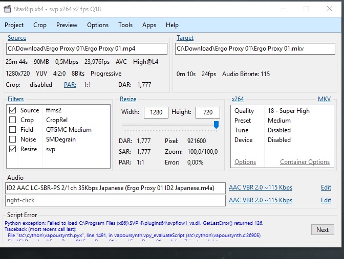

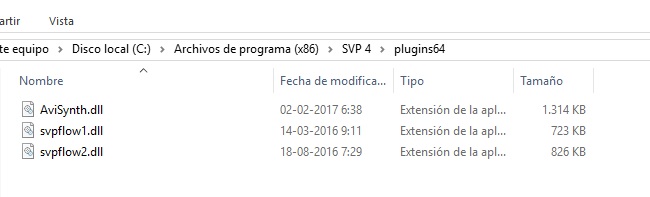

Hello again.
After a time trying to figure how to follow the guide, i cant remember but the software request me to installl Python and Vapoursynth.
I clic in Project > Template > svp x264 x2 fps Q18 (Nothing more, idk is I need to follow the images, cant realize where...)
Clic source > choose my vid > pop-up window appears for 4 second > image below
Im missing the svpflow, I download from  http://www.svp-team.com/forum/viewtopic … 800#p61800
And get the same error
Sin título.jpg, 122 kb, 672 x 507
Sin título2.jpg, 27.44 kb, 650 x 197

https://lh3.googleusercontent.com/-GsPl6s55O1Y/WLYFVODKCZI/AAAAAAAAOKg/xrMaR_QP_3w/s0/explorer_2017-03-01_02-18-40.png
Libs must be VS x64 not regular AVS
