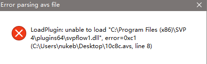

As you know what that pic is, I use my svp4 (x32/64 engine) with mpc-hc x32/64,and MeGUI, when i use the x32 mpc-hc ,it function normally whit avs script in MeGUI , but when i use  x64 mpc-hc with my svp 64engine,the avs script that generated by (svp 4 x64-engine) //a plugins64 named svpflow1.dll //doesn't work in MeGUI anyway,and a error displayed with '
LoadPlugin: unable to load "C:\Program Files (x86)\SVP 4\plugins64\svpflow1.dll",error=0xc1 (C:\Users\nukeb\Desktop\10c8c.avs,line 8)'
sounds like its a plugins64-error ,but it's not, i've been try to change my ( svpflow1.dll/svpflow2.dll files in that folder) by download from svp-team.com ,but it still doesn't works anyway .so i am here looking for some another way to fix this nagtive problem ,anyone got a idea with this??
plz her help! i'm appreciate that and thx a lot for your help/idea/anything!

And original generated avs script is here:

Are you sure you're not feeding 32-bit MeGui with 64-bit script?
Re: Hey guys ,I think i got a nagtive problem here ,plz help!
Great work!!THANK YOU~  and that error were fixed by your solutions!!
And now i could use SVP 4 avs Script in MeGUI 64bit now,

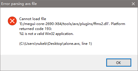

but unfortunately here is a new error-box says "%1 Not a valid Win32 bit application" when i was using some kind of other plugins (&those plugins are functioning normally in MeGUI 32bit) ,[(you could check that error in pic)]
So, is this error means those plugins are incompatible to work with MeGUI 64bit ? Btw ,my operating system is windows 10 / should i change some compatible options in plugins ,or??

Thank you bro~  ,everything is alright now ,i think i got my problem fixed.
To fix that error("%1 Not a valid Win32 bit application") ,
The  easy solution ,just go find (x64) .dll plugin's version ,download it and replace those plugins to the original path,
then those (x64) .dll plugins  just return to the right track and working again with MeGUI (64bit)~!!
