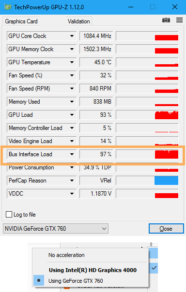

Re: Using SVP with an external GPU
Bad news. When you mentioned OpenCL, I remembered that GPU-Z didn't show a checkmark next to it (or CUDA). I disabled the 740M and now both OpenCL and CUDA work. SVP does see the card and can use it, but the bandwidth (x1 pci-e 2.0) is too low, making it unusable. Thought this might be the case, but wanted to give it a try anyway.
The card is a GTX 760. I bought an RX 480, but it doesn't work for some reason, so in the meantime I took my brother's GTX 760 and gave him my RX 480. Works fine for games, not so much for SVP.
svp2.png, 18.15 kb, 384 x 600
1920*1080*2*60*8 *1.5 = ~ 3 Gbit/s
yeah, it may not work

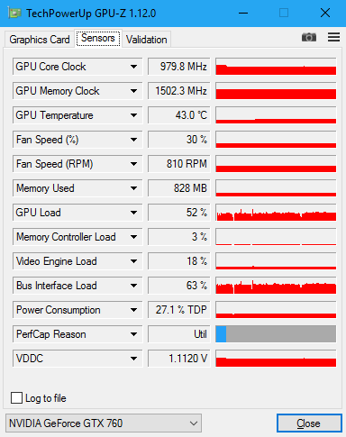

I tested it at 720p just to see if it works and it does indeed, it uses around 65% of the available bandwidth. Therefore, 1080p would need ~150%.
svp720p.png, 14.32 kb, 384 x 485
