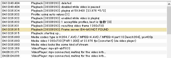

I can play 60fps with MPC-HC but can't with PLEX mediaplayer.
Of course, I did that...https://www.svp-team.com/wiki/SVP:Plex_Media_Player
When I see event log, there is an warning that "Playback [38209293]: Frame server (64-bit) NOT FOUND"
Probably I think that this is cause of the problem.
But I don't know how to solve it.
Those who are using SVP with PLEX need to teach.
problem.JPG, 48.03 kb, 589 x 200

Are you sure you installed 64 bit engine of SVP? You can check those under additional software and utilities.
Re: Can't play on 60fps with PLEX mediaplayer
You didn't replace "mpv-1.dll" file.
> copy "C:\Program Files (x86)\SVP 4\mpv64\mpv-1.dll" to "C:\Program Files\Plex\Plex Media Player\"
