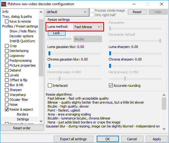

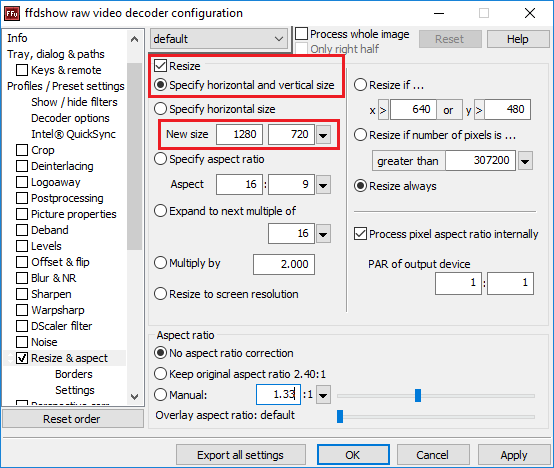

You can "override" default SVP downscaling algorithm BicubicResize by ffdShow's Fast Resize. I got economy by 2% CPU load. Try it smile
ffdShow_resize.png, 28.77 kb, 554 x 468
ffdShow_resize_settings.png, 29.56 kb, 554 x 468
Thanks!  I'll definitely look into this.  While it may only be 2% for you, it could very well be much more on my weaker hardware.

OK yeah, on my CPU it's actually a difference of 10% CPU utilization - for reference that's basically the difference between decoding Xvid vs decoding VP9 (both in software).
With SVP's downscaling I was only able to do half pixel + 16px with Xvid (VP9 required too much CPU).  Using "fast billinear" downscaling, I was able to do half pixel + 16px with VP9 at similar CPU utilization.
