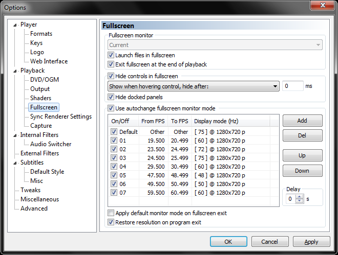

To actually take advantage of these frame rates and/or refresh rates, I highly recommend using MPC-HC's "automatic resolution changer", madVR's display modes functionality, or mpv's autospeedwin script; see the attached image at the end of this post for an example of a good configuration in MPC-HC for a 75Hz display (again, note that it does not take into account any fractional frame rates).
The "From FPS" and "To FPS" values in MPC-HC are merely the range of frame rates (before interpolation) that the according "Display Mode" should apply to; it does not actually change the source video's frame rate (that would require something like ReClock or the according similar functionality in mpv).

MPC-HC.png, 59.57 kb, 660 x 499
