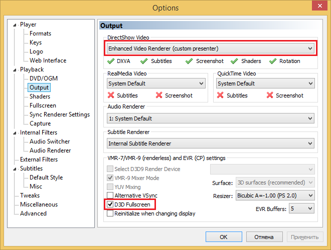

Start from changing video renderer to EVR Custom with D3D Fullsreen option enabled:
MPC-HC - menu View - Options - Output

Re: How Do I Make SVP 4 Play Smoother?
Thanks, that helped a little bit but I still see some tearing/skipping. I'm using a GTX 980 with the latest drivers and i'm using the default render that was automatically selected when I installed SVP.

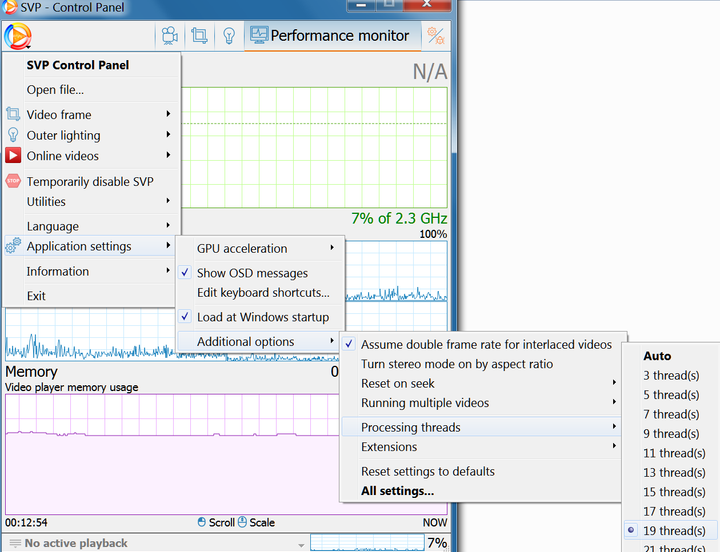

Try to manually increase the amount of processing threads that SVP uses (see attached image).  Start with 7 threads and then try 11, 15, 19, etc... (fewer threads = lower CPU utilization, but too low of threads = poor SVP performance)
And to clarify, are you running SVP Free or Pro?
