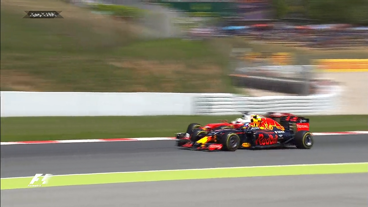

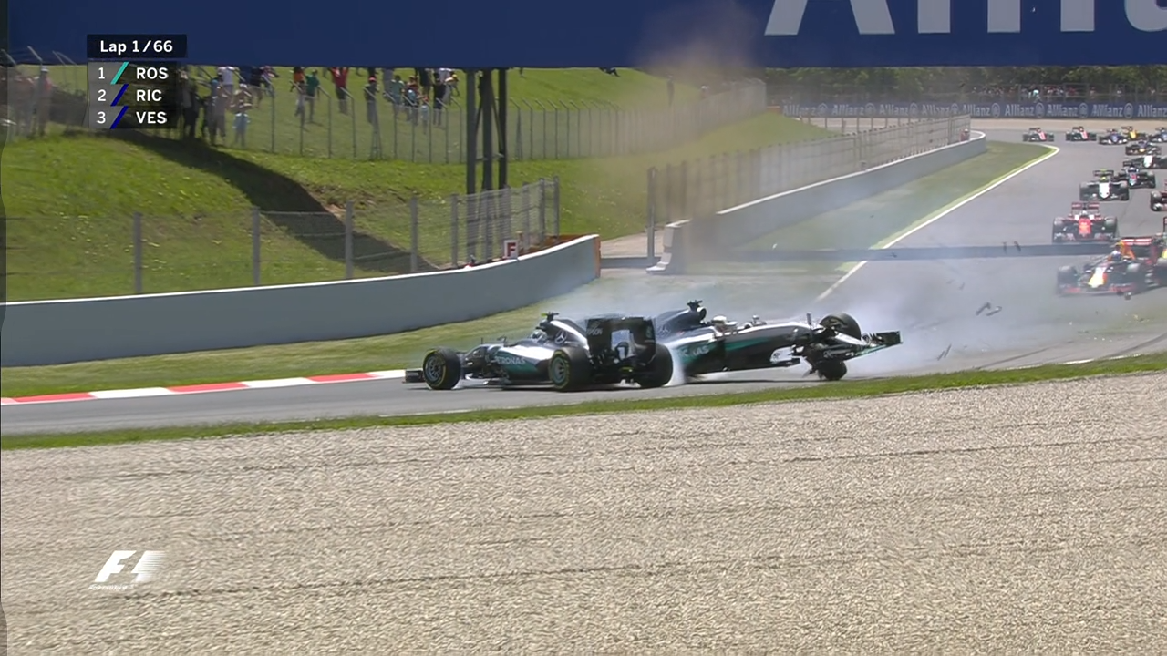

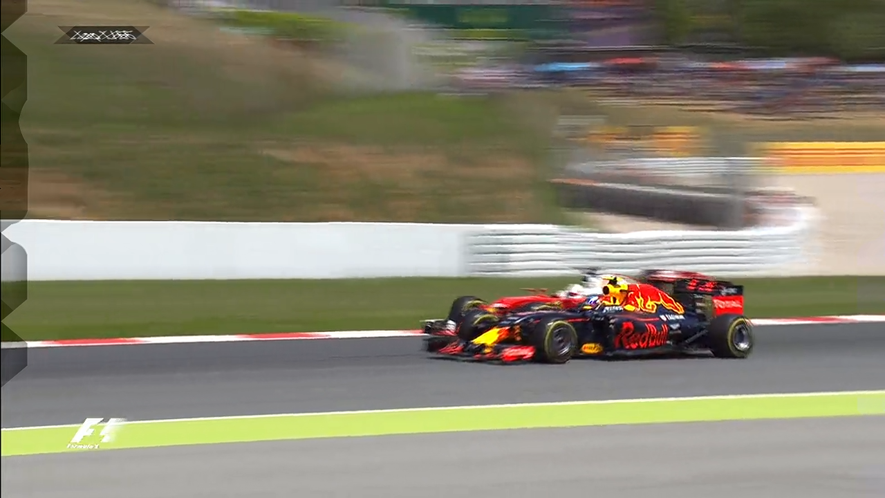

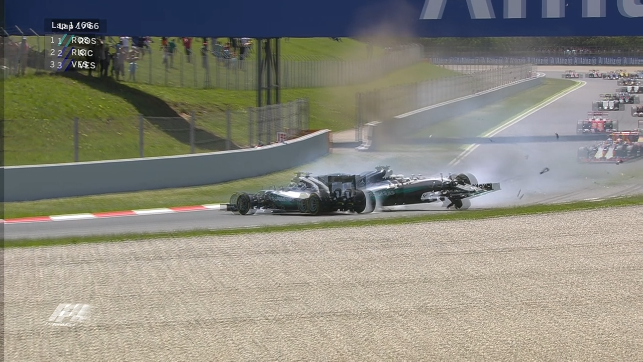

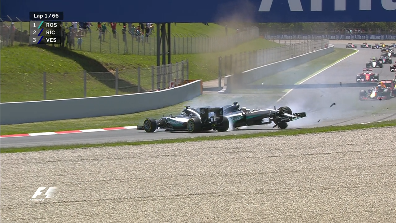

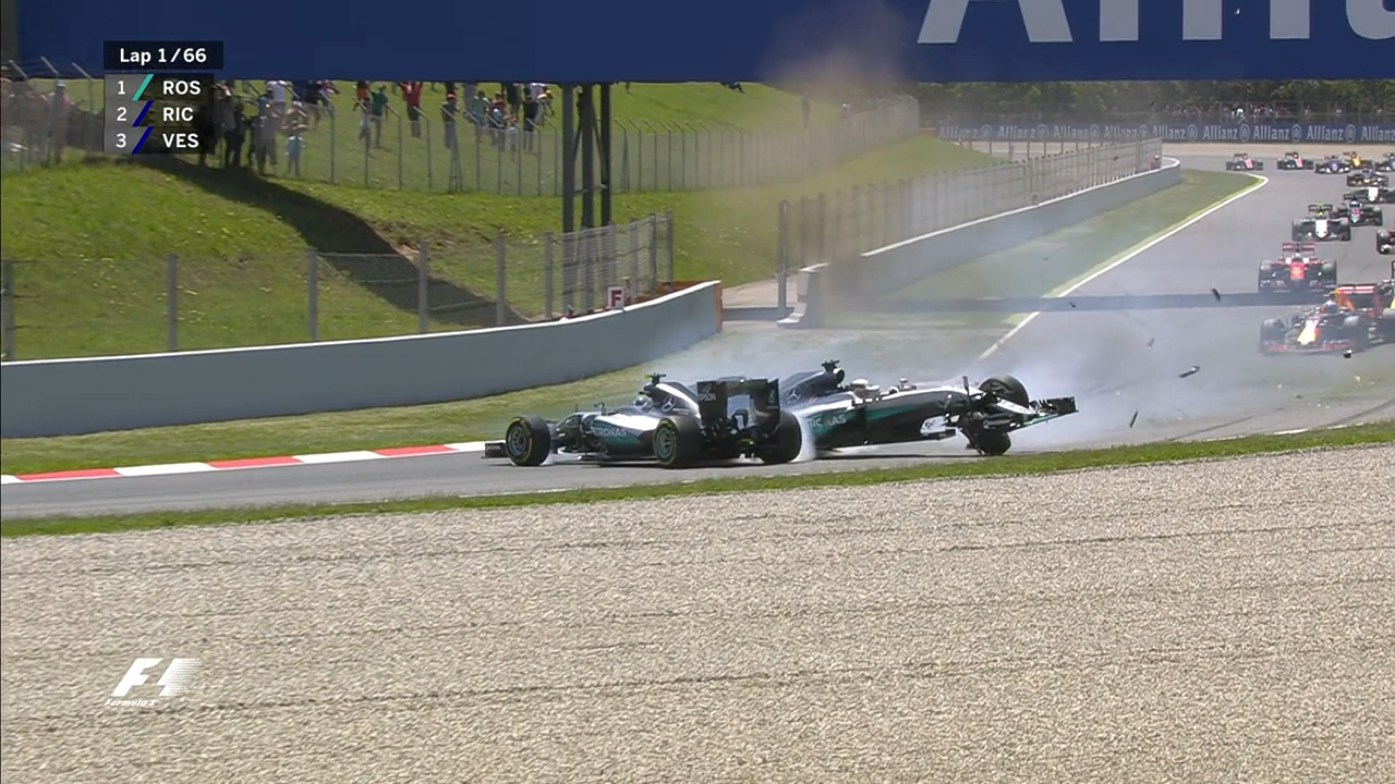

Apologizes for the double-post so soon after the previous post, but I've just run into a pretty big issue.
It turns out that one of my real-world test videos has an annoying flicker-like artifact when "smooth.cubic = 0;" is set, but looks nearly flawless with that setting commented out.
Link to the video in question - see attachments in the following post:
http://www.svp-team.com/forum/viewtopic … 730#p60730

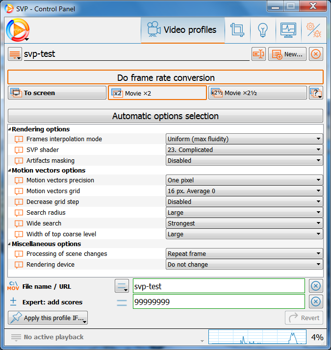

I've also attached a screenshot showing the flicker-like artifact as well as a screenshot showing the exact same frame but with cubic enabled and therefore without the flicker-like artifact.

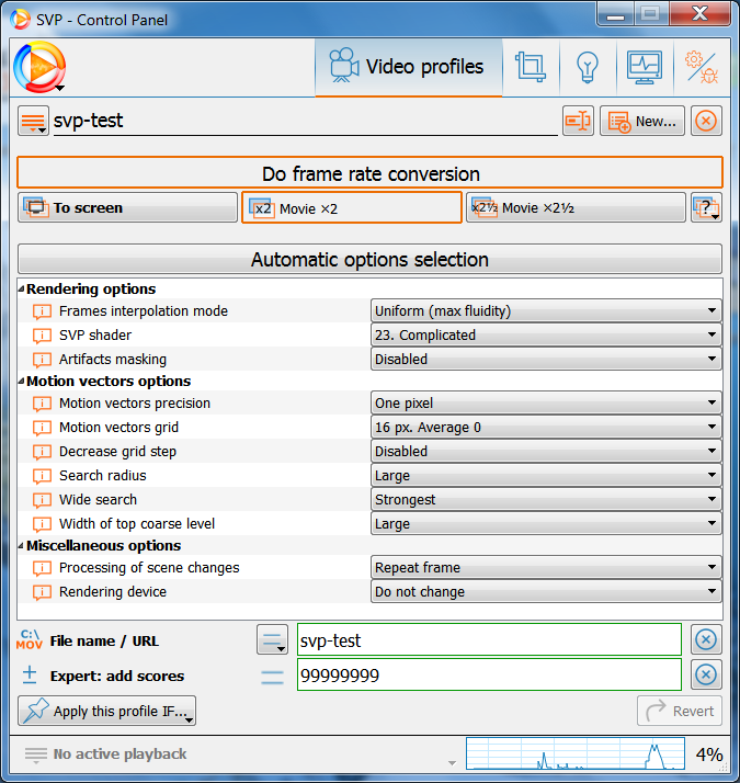

EDIT: In an attempt to cover all my bases, I've also attached a screenshot of the SVP test settings I was using as well as the source frames just before and after the example flicker-inducing frame.
Normally I'd attach logs as well, but honestly they're like exactly the same between using cubic and not using cubic.
EDIT 2: I just did more testing and it turns out that 1775MHz is stable for SVP but not for the likes of Furmark - I have to use something like 1750MHz to be Furmark-stable (again, GPU temps are fine - they max out ~60c).
EDIT 3: All in all, I'd really like to know one thing - is there a way to specifically prevent this crazy flicker-like artifact while also having "smooth.cubic = 0;" active without reducing my SVP profile settings or disable GPU acceleration?  This is literally the final thing preventing my "new" HTPC from being fully functional.

15 (edited by Nintendo Maniac 64 30-07-2016 22:59:32)
Re: Anyway to only partly reduce the GPU load from SVP's GPU acceleration?
I hate to triple post, but it's been nearly 5 days, my "new" HTPC is fully up and running, and there's been no response to my previous post... Maybe I'm simply asking the wrong question?
If that's the case, then let me ask this - is the massive visual difference in the interpolated frames for "cubic enabled" and "cubic disabled" the expected result?
In other words, is my so-called "issue" that I am running into actually not a problem at all and is in fact normal operation?

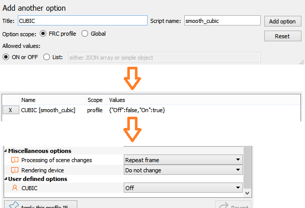

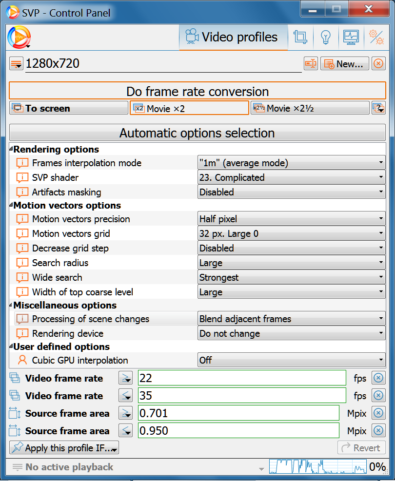

ANYWAY...one last quick question - is there any way I can add the smooth.cubic setting via Application settings -> Additional options -> All settings -> User defined options like the override.js recommends one to do?
svp4-custom-option.png, 14.39 kb, 599 x 408
18 (edited by Nintendo Maniac 64 05-08-2016 12:26:49)
Thanks, that GUI option is exactly what I was looking for since it lets me toggle it depending on the video resolution.

In similar news, I couldn't help but notice that using GPU interpolation (whether cubic or not) results in more "boarder edge" artifacts than if I used CPU-only interpolation, especially with "complicated" + "half pixel".
EDIT: I've attached a video clip that has this issue as well as two screenshots showing the result with GPU interpolation and the other showing CPU-only interpolation.
I've also made a bug report for this issue.
SVP settings.png, 104.02 kb, 810 x 987
