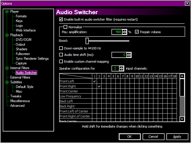

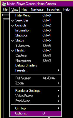

In 32bit MPC-HC, go to View -> Options
Then under "Internal Filters" select "Audio Switcher".  Make sure all the options are unchecked except "Enable built-in audio switcher filter (requires restart)".
Restart MPC-HC and test your audio to see if it works.

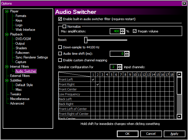

If that doesn't work, then do the exact same thing but then uncheck everything, yes including "Enable built-in audio switcher filter (requires restart)".
Again, restart MPC-HC and test your audio to see if it works.
