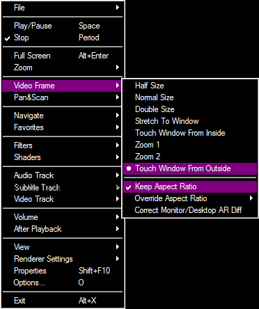

The best thing you can do at this point is to not crop at all and instead, in MPC-HC, right click on the video area and select "Touch Window from Outside" and making sure "Keep Aspect Ratio" is checked.
Then from there use the pan & scan function to move the video down/move your viewing area up (you can change the keyboard key for this function in MPC-HC's options fyi).
right-click.png, 6.8 kb, 372 x 444
