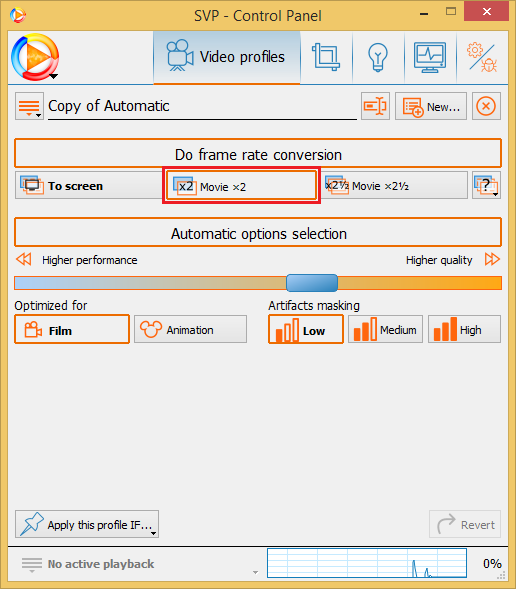

Use constant framerate multiply factor. In your case it must be x2.
SVP4_x2_smooth_factor.png, 31.8 kb, 516 x 589

Looks like you have "hardcoded" 2:3 pulldown NTSC disk because "Big Trouble in Little China" is a 24 fps movie on the 30 fps DVD. You need somehow to decimate 24 fps from 30 (23.976 from 29.97). Maybe it already does some decoder or filter in your player. You can check it by view it frame by frame (Ctrl + right arrow in pause mode). If you don't see repeated frames then to smooth it in SVP just select constant smooth factor "Movie x2.5". Righter "Movie x2". See picture above.
x2.5 factor must help with your disc "Petunia" as it has 23.976 fps.

Setting "Movie x2.5" on both movies solved all the issues, they now play perfectly smooth with 0 frame drops!
THANK YOU SO MUCH MAG FOR THE HELP!
