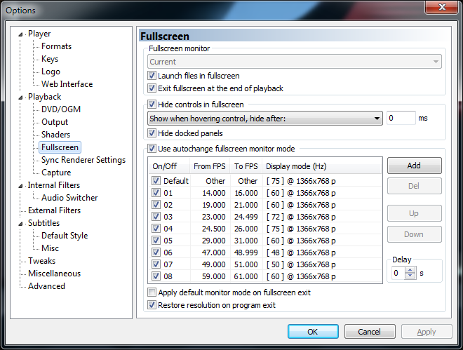

123 (edited by Nintendo Maniac 64 30-04-2016 21:17:05)
Re: SVP 4 Stuttering problem while watching anime
Honestly you could probably just copy the settings I use on my laptop; the only main difference is that I use 75Hz as my screen's default rather than 72Hz.
Automatic resolution changer.png, 58.25 kb, 660 x 499
Ok...but why do i need to do this?
125 (edited by Nintendo Maniac 64 01-05-2016 08:04:24)
You don't have to do it, that's why I said "if you get bored again".
The idea was that, in your boredom, you could use my settings as a starting point and then from there fiddle around with the settings and see what the difference is for yourself.
