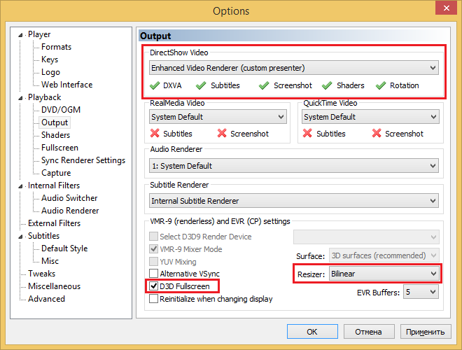

Did you try EVR Custom renderer with D3D Fullscreen? It eats less memory than madVR.
EVR_with_D3D.png, 33.62 kb, 660 x 500

EVR does take less RAM, but I want to use madVR (I want to use SIMM downscaling, error diffusion and debanding)
I know you didn't actually say it in your text, but in the image you highlight the resizer being set to "Bilinear".
I think it's safe to say that, if someone is trying to play 2160p videos that they can take the minor increase in CPU utilization that comes from using Bicubic specifically for downscaling.
It is for less CPU and GPU load and to reduce use of memory. It is just the lighter renderer for low performance PC and for test purposes to detect if error in madVR or not. wink

[Bilinear] is for less CPU and GPU load and to reduce use of memory. It is just the lighter renderer for low performance PC and for test purposes to detect if error in madVR or not. wink
But does it really make that big of a difference?  I just thought that, unless your system has really el-lame-o graphics (10+ year old Intel graphics), the difference in performance is negligible (at least it seems that way on my AMD E-350 vs Core 2 Duo + 965GMA iGP).
