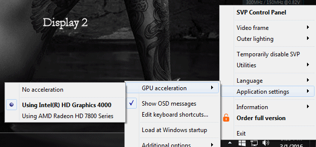

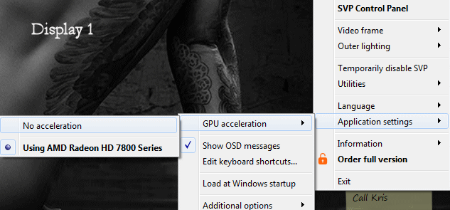

That's my problem - the Intel HD4000 doesn't appear in the SVP 4 > Application Settings > GPU Acceleration menu. The AMD HD 7850 is the only choice. It's like I somehow need to 'turn on' the HD4000. It shows as 'working properly' in the Device Manager. I'm not sure how to go about configuring it... Keep in mind that although I'm an old hand with PC building and repair I've yet to configure a rig with integrated and discrete GPUs. Thanks for all your help - I needed it smile
Re: Avisynth error when using the latest 32-bit svpflow dlls
Oh, that.  The usual solution is to use DDU to uninstall any and all Intel, AMD, and Nvidia drivers and then re-install your GPU drivers.
The only thing is, I never know whether to install the integrated GPU drivers first or the discrete GPU drivers first...

19 (edited by MistahBonzai 02-03-2016 03:51:01)
I believe that one needs a MoBo and BIOS designed to support multi-GPU functionality. Otherwise, assuming one gets it working, they will end up as I did with 2 separate video streams with no sharing of the load.  I included 2 screen clips, one from the 'main' display and one from the extend display. The main display is connected to the AMD HD 7850 while the extended display is connected to the Intel HD500 (MoBo HDMI).
I can reverse the main/extended displays in the windows screen resolution settings and the GPU follows it - it interchanges the taskbar and such. Anyway, see the attached screen clips showing the status of the SVP 4 application settings. Bottomline is that it's kinda fun to mess around with but it does nothing to help share the video load. I have become really good at switching inputs on my Sony Bravia with the remote cool
display1 HD 7850.gif, 40.1 kb, 633 x 295
display2 HD4000.gif, 40.56 kb, 633 x 295
