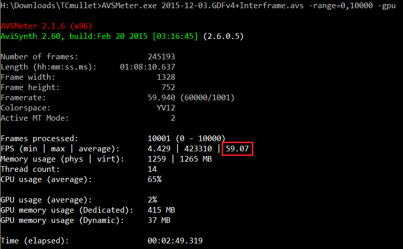

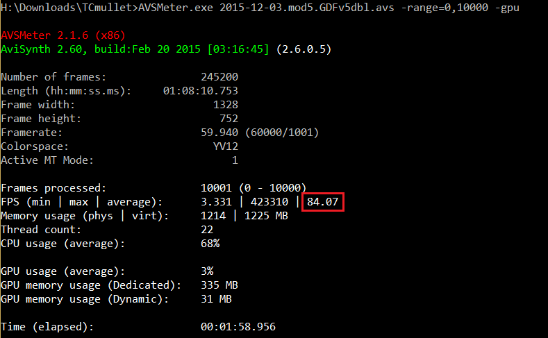

Re: Fixing dropped frames in action cam footage? (for stereoscopic 3D)
TCmullet
In your script I did 6 modifications:
mod1. added distributor() to the end of script. It lets script to use multi-thread processing. Significant speedup in AvsPmod and player. For x264 and AVSMeter it is not necessary
mod2. added SetMTMode(1) just after AudioDub(video,audio) to to less memory use
mod3. moved AddBorders(0,0,0,8) just after GameDropFix line. It gives more quality to interpolated frames
mod4. change global threads=4 to global threads=7 to use more CPU to get more speed
mod5. use GameDropFixV5 instead of GameDropFix4
mod6. change Interframe call to DblFPS=true parameter inside GameDropFixV5
Script before changes: GDFv4_speed.png - 59 fps
Script after changes: GDFv5_speed.png - 84 fps
GDFv4_speed.png, 14.28 kb, 789 x 487
GDFv5_speed.png, 14.18 kb, 789 x 487
