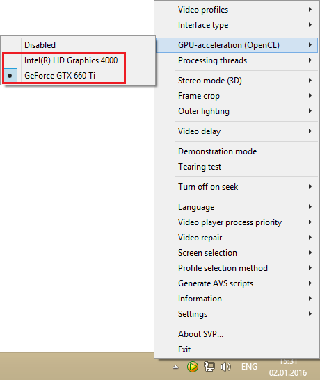

Where you saw that? In SVP 3.1.7 tray icon menu?
Then yes. Nintendo Maniac 64 is right. Reinstall your NVIDIA driver. And for your internal graphics too (Intel HD Graphics 4600).
I you did it right then you will see submenu for selection one of your GPUs. Like this:
GPU-acceleration_NVIDIA+Intel.png, 15.37 kb, 460 x 547
