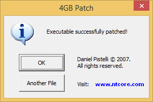

2. Did you try to apply 4GB patch to VirtualDub.exe file?
142
Re: Fixing dropped frames in action cam footage? (for stereoscopic 3D)
2. I mean: Start button - SVP - 4GB Patch - select VirtualDub.exe file - OK.
You will see message.
4GB_Patch_message.png, 5.8 kb, 300 x 200

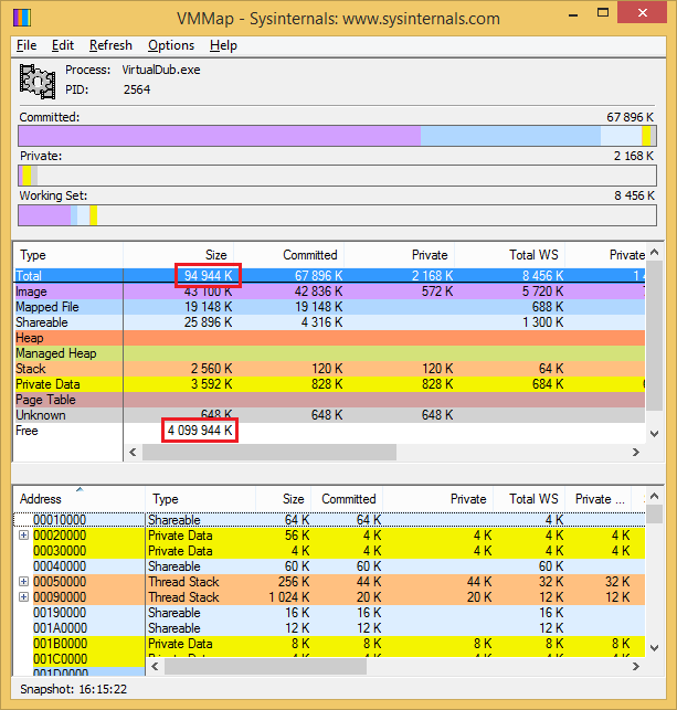

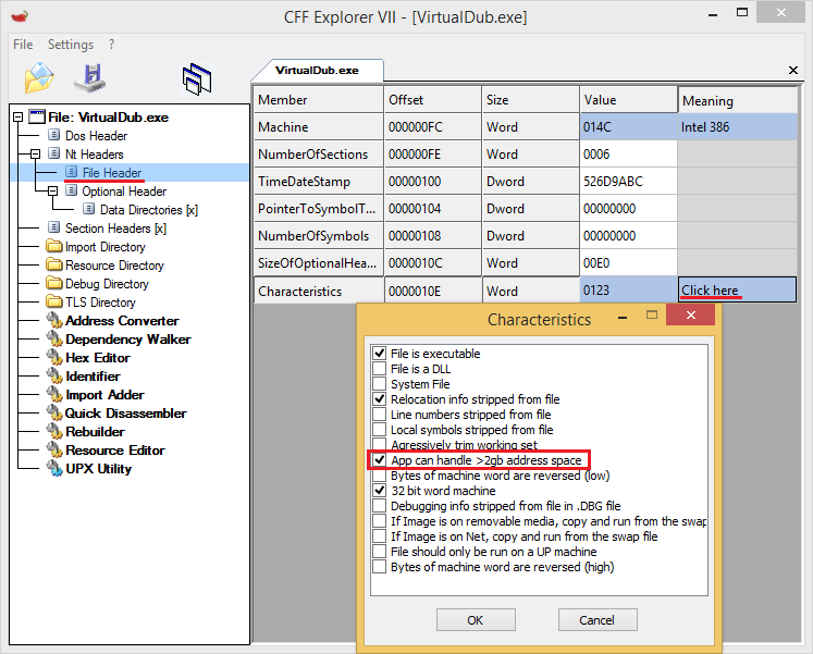

4GB Patch, LargeAddressAware.exe and others such utils do one thing: change one bit in PE32 header of file.
So, I think yes. LargeAddressAware.exe does the same.
You can check result by CCF Explorer or VMMap. Option 'App can handle >2gb address space' in CCF Explorer must be enabled. Sum of Total+Free in VMMap must be about 4 200 000 K.
CCF_Explorer.png, 44.73 kb, 747 x 601
VMMap.png, 32.25 kb, 613 x 643
