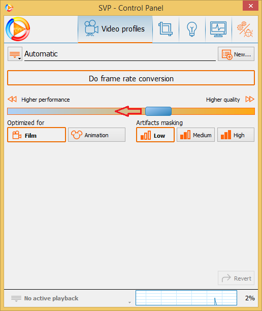

Seek bar in fullscreen can be two types:
1) native MPC-HC; or
2) rendered with the frames by renderer (madVR's exclusive mode; EVR's D3D Fullscreen mode).
You see slow appearing in the first case. Do you?
Then try to reduce complexity of SVP computations: move sliderbar to Higher performance.
SVP4_Higher_performance.png, 24.14 kb, 516 x 612

cycletYou see slow appearing in the first case. Do you?
This was the first thing I tried playing around with but no matter what the seek bar was still slow to come up.
