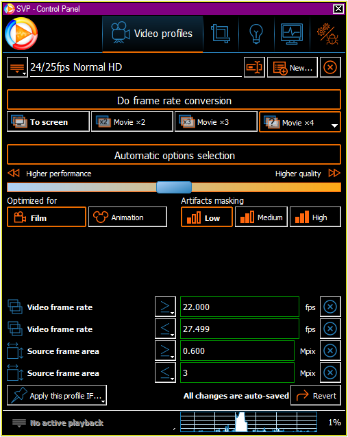

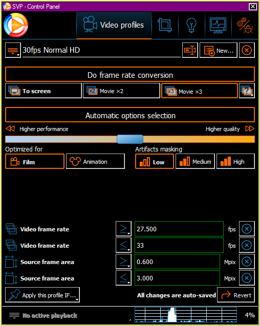

It's probably because the framerate is changing 23.983 and 23.925 fps.
I myself have noticed this behavior in SVP4 with variable framerates (particularly VP9/WebM videos), but I've "worked around" the issue by using SVP4 Pro's "Movie x2" (and x3 and x4) functionality combined with seperate profiles for 24/25fps and 30fps content where the framerate ranges are 22-27.499fps and 27.5-33fps respectively.
24-25.png, 30.3 kb, 508 x 637
30.png, 30.17 kb, 508 x 637
